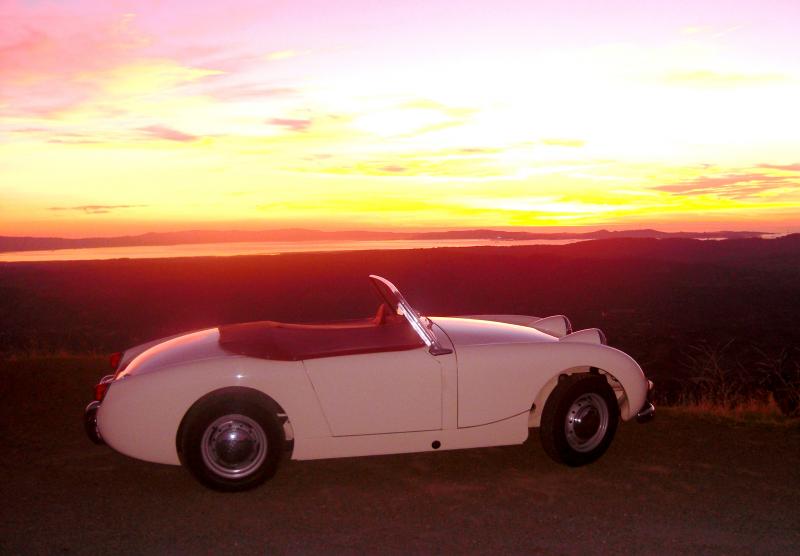

So I put together my old/show car BE a few years ago. I started with a painted tube in good shape. I had the short block rebuilt on the outside, but rebuilt everything else including the transmission myself. I was working full time and I'd estimate that I spent 5-10 hours a week. A lot of the time was finding parts that were good enough to be finished to the quality I wanted. Time was 18 months from start to finish....that would be 375 to 750 hours. Have fun! If you want to just put the car together without a lot of refinishing/searching for parts....I think 200 would be a good number.

Man - you did a beautiful job Bill!! Have you ever gone to the Van Dusen Botanical Gardens car show in Vancouver in late May?
