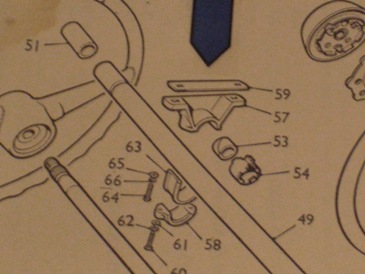

Hi all,
After putting the steering together on my BE, I realize the parts book shows a shim at the top of the inside steering bracket. It was not with all the rest of the parts, boxes, bags, etc. You know the story. It is item 59 in the drawing. Does anyone have a spare they could part with, or could someone tell me the thickness?

I thought those were shimmed as needed to align the steering shaft with the rack. The rack mounts are shimmed to get the horizontal angle right and the shaft mount is shimmed to get the vertical alignment.
Whitephrog
That is what they are for. You might need two. You might not need any.

Check to see that the steering column hits the center of the horn ring plastic thing. Shim to suit!

That is the column shim, some cars had none, some had 5.
As someone said, shim as necessary. A couple of washers will work too.
jlaird
Aye, use washers till you get the correct shim/shims.
