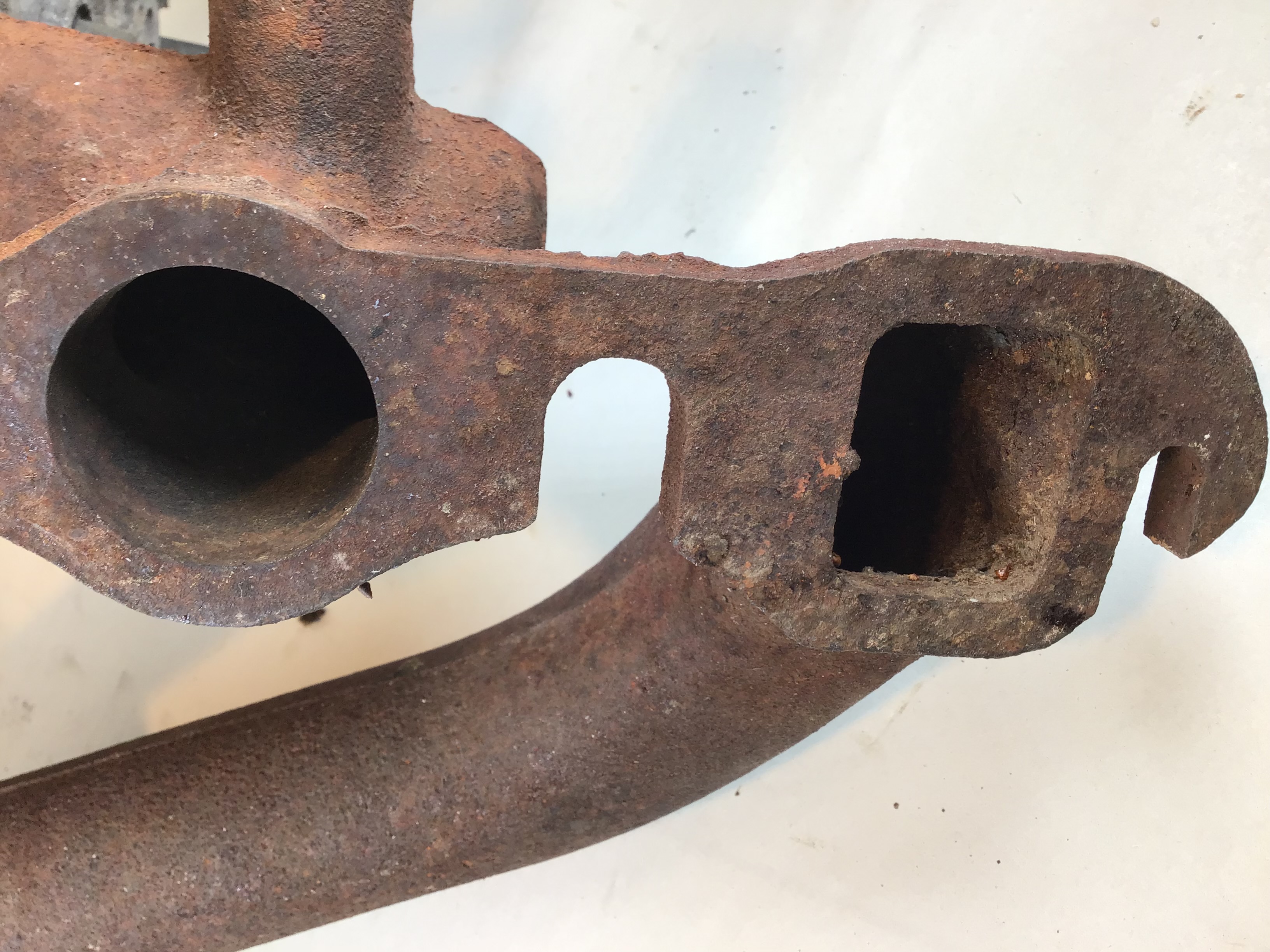

What is this part for? I have a cast together intake/exhaust MGB manifold with a single SU HIF 4 carburetor. The exhaust has two part numbers. One number on each exhaust branch ; 12H3620 and 12H3582. Have looked extensively on line with no results.
PAUL161
How about a picture? PJ

PAUL161
Tom, do you have an idea? I'm at a total loss on this one. I think it's safe to say it's not from an MGB! Austin maybe?
PAUL161
OK, seems to be from an Austin Marina from 1972 to 1974.

NutmegCT

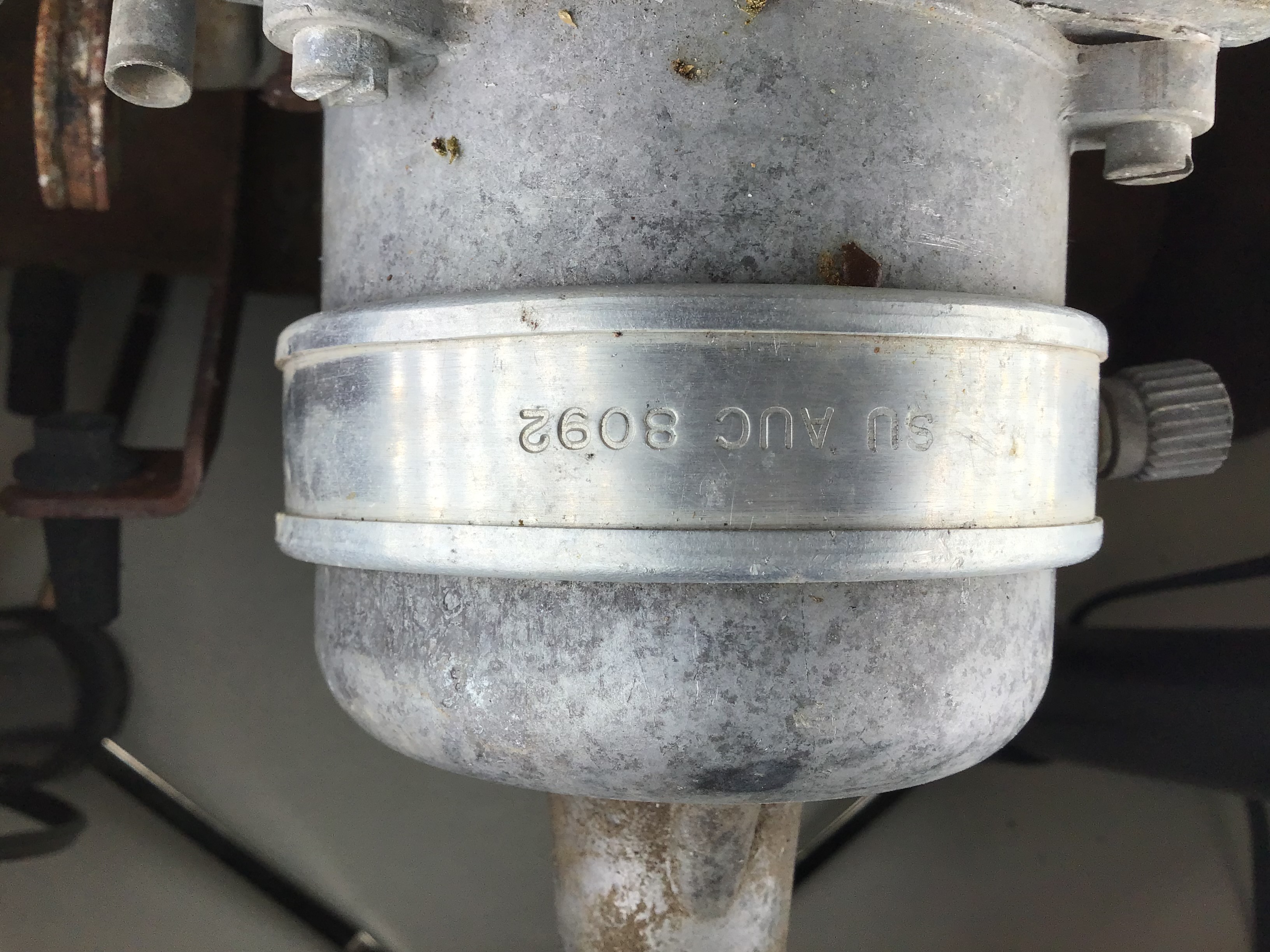

note that "su auc 8092" indicates an SU carb heater.
Is "I Drive MGB" asking about the carburetor? or the exhaust manifold?
If he's asking about the manifold, those two numbers he gave were on the Austin Marina manifold, as Paul says.
PAUL161
The bowl heater in the picture is the first I've ever seen on an SU. Learn something new every day! :thumbsup2:
EricG
I had an early 850 Mini with one of the carb heaters on it. Worked well to prevent carb icing in very cold weather (like we are having now in South Carolina!)
