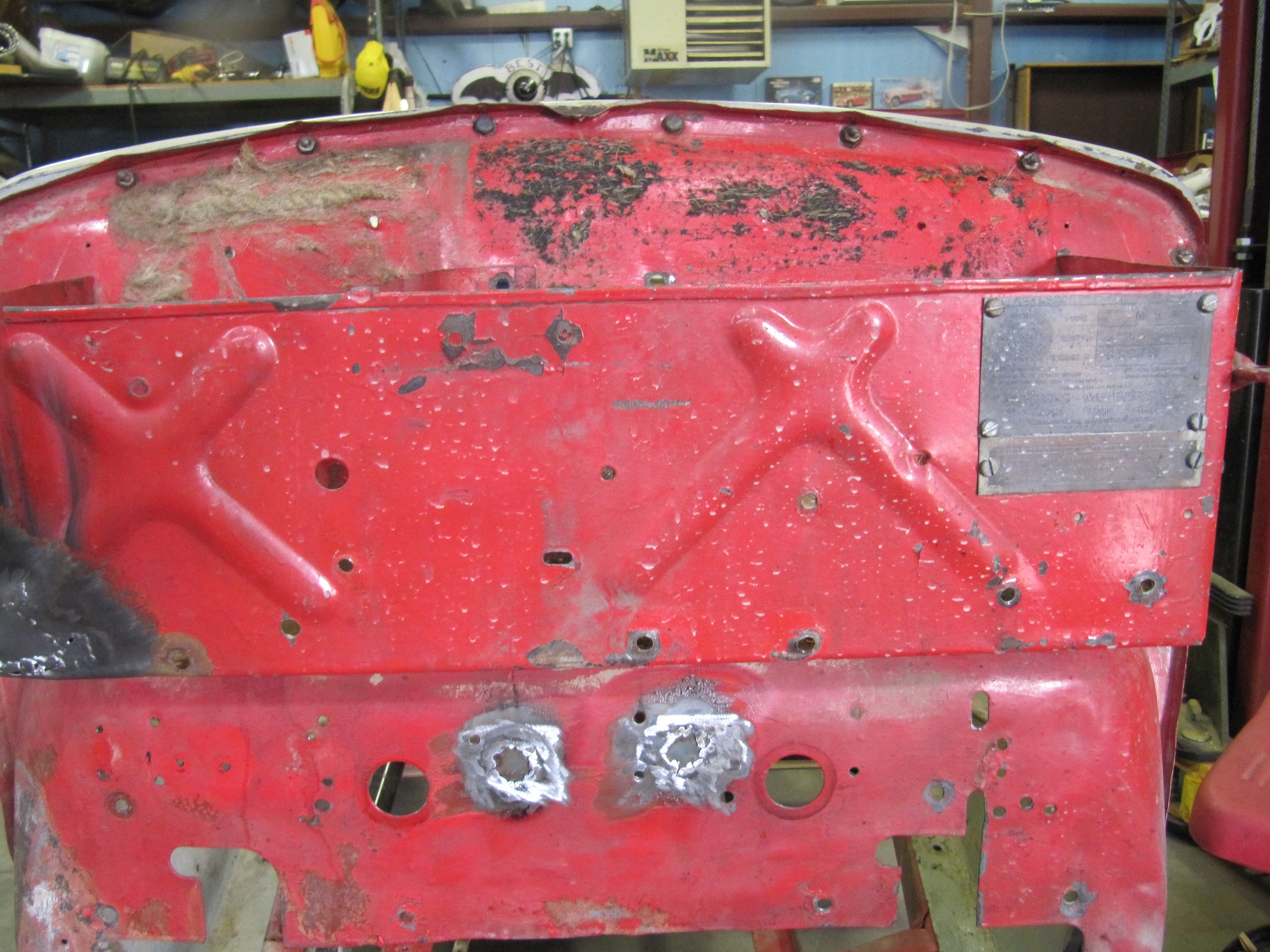

Good morning I recently dug my morris eight out of storage to start building and was wondering if anyone on here can help me identify it further as I don't really know much about the car and the guy I brought it off had no information either.
I've been trying to locate the chassis number and on 1 document I found online states there none stamped on the frame but there should be a brass or aluminium plate on the bulkhead however 90% of my bulkhead has long rotted away and where it details there should be the plate is a gapping hole.

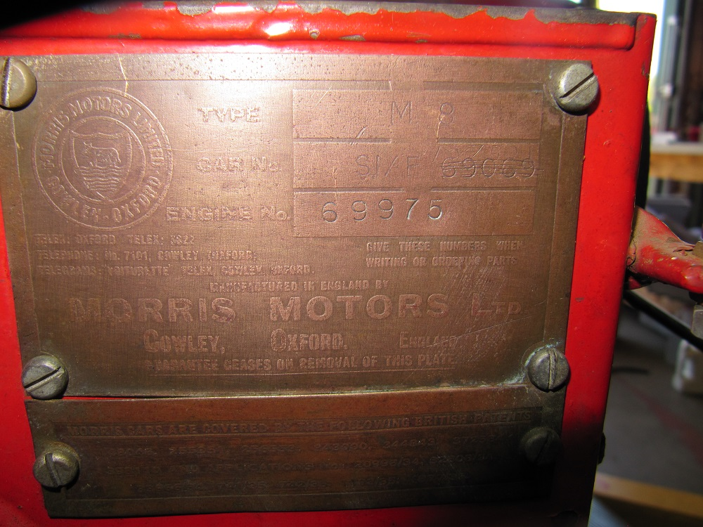

I have however found 2 small plates in the bulk head 1 with P4DEF - 233 and the other with B E F 5767 stamped into it. The only reference I can find online with P4DEF is a 1947 morris eight that went to auction.
So I guess my questions are:
Would I be correct is assuming mine is of the same/similar year?
what is the 233 after?
What does B E F 5767 refer to?
Can any of these be used to track down the missing chassis number so I can apply for the log book and age related plate?
Unfortunately it's not letting me upload a pic of it at the moment but as soon as I can sort the issue out I'll post some to help
Thanks rik
Edited to add pics.

I sold my Morris 8 but the vin plate was mounted engine side of where the battery stores. My car was a Tourer, but I bet they all mounted the same. It was made of brass and very visible. The vin number was also stamped on the right hand top of the frame rail by the engine. Very hard to read as paint fills in the numbers. I will look for a picture. My car was a 1936. Your engine number may also match a brass plate on your engine but Morris had an engine exchange program. You turn in your old engine and pay a little money and get a a rebuilt engine. Mine had a Morris factory rebuild from 1950.

found this online it may help shed some light on the subject, ther is a reference to EF xxxx worht a read.
ENGINE/CHASSIS/BODY NUMBERS MORRIS 8 CARS 1934 to 1938
Engine Numbers.
These numbers were stamped on the Bulkhead Plate.
New original engines had these numbers stamped on the engine block usually (but not exclusively) with a
UB prefix.
Early Pre-Series engines may have had the number stamped on a ‘cast in’ raised area on the starter motor
side of the cylinder block.
But generally all engines had the number stamped on a ‘cast-in’ sloping face on the manifold side of the
cylinder block towards the rear and immediately below the cylinder head joint.
In general the numbers roughly correspond with the chassis number within a hundred or two, but do not
always follow consistently.
If your engine is not stamped as described above, then it will be a replacement engine.
Chassis Numbers.
They were also stamped on the top face of the chassis near the front on the offside (driver’s side for RH
drive cars) in the vicinity of the area above the steering column mounting bracket. They are normally hidden
under the felt strip between front wing assembly and chassis and are therefore not immediately in view.
However if you look just forward of the small plate used to access the steering box mounting bolt, and if the
wing/chassis joint felt is not in the way, the number can be seen. Whilst being stamped an indentation was
made by the impact and this sometimes retains water and corrodes, often rendering the number illegible.
On the bulkhead plate only, the added prefix of 35/E, S1/E and S2/E is included dependent on the
specification and year of manufacture.

No VIN numbers were used in the 1930s, basically the chassis number was used instead.
mezy
also found this
Frame (Chassis) Number
(1) All the Morris pre-series models up to 1935
The Number is stamped onto the casting, right at
the front end of the dumb iron, (where the spring
fixes to the chassis), on the offside (driver’s side) of
the chassis. The number is stamped just above
where the shackle pin goes through the casting.
(2) Morris 8 cars and vans from 1935 to 1938
The Number is stamped on the top of the chassis
rail alongside the steering box, and there is a cut-out
in the flange of the inner wing so that the number
can be seen without dismantling. The numbers are
often faint, and may be concealed by years of rust,
paint and dirt.
(3) Morris 8 Series E and Series Z van
There is, to the best of our knowledge, no Number
stamped on the chassis
Link https://morrisregister.co.uk/wp-content/uploads/2018/09/Finding-Numbers.pdf
