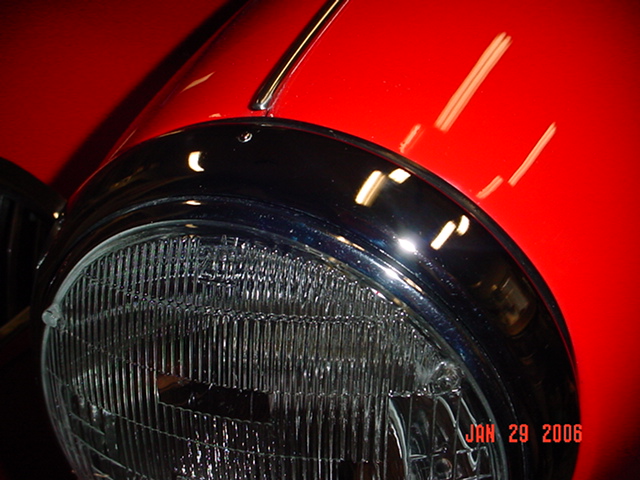

Seems pretty clear that proper headlight rims have a nickel plated brass rivet at their tops. One of the rims from my 66 BJ8 does have such a rivet, in pretty good shape, except that it appears to be copper, and all plating is gone. The other rim has a rivet, still plated, but well worn down. Both rims need re-plating. So the question is whether a correct appearing rivet can be found. Effective plating requires removal of the old rivets, which will pretty well destroy the one good rivet. The last resort appears to be the new Lucas units available from BCS, but at almost $100 each, thought I'd try other options first. Any ideas?

The rims I got from BCS a few years ago had rivets but the finish was so poor that I returned them. Full of grinder marks.
I got non rivet rims from Moss which had very good plating. Drilled the rims, got copper plated steel rivets from the local hardware, buffed the copper off to underlying bare steel, installed the rivets & called it a job. Can't tell them from the real thing. See pic
Maybe BCS has improved their quality by now?

Hi guys. Just went to the shop and found some nickel plated mild steel split rivets of the proper size. A quick buffing leaves them quite nice. I'd feel better if they were not steel, due to the inevitable rusting issue, but for now, they will look great. Now to decide whether to re-plate the original brass rims or go with a Moss replacement and follow Dave's plan. Dave - are the Moss rims brass or steel?

I live in a dry climate & keep the rivets waxed. Ha!
Have no idea whether they are brass or steel - I suspect steel. Didn't really pay attention. All visible surfaces are plated.

Thanks. I saw that. Think I'm just going to have mine chromed, as I have found suitable, though not exact, replacement rivets. This is a frustrating enterprise. Made all arrangements to pick up my car after almost thirteen months in the paint shop. Upon "final" inspection today, I found four spots that needed re-work. Another week --- AAAARGH.
