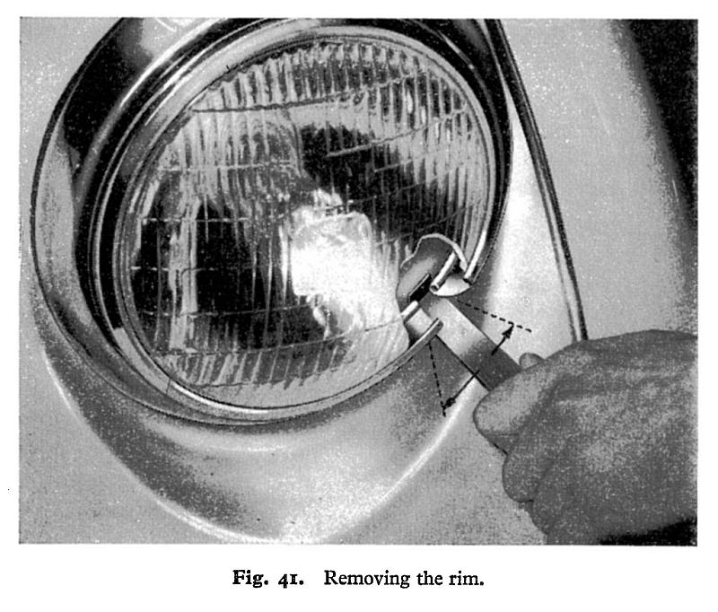

I feel like a bit of a goof asking this but I can't remember how I did this before, it was a very long time ago. How do you get the trim rings off to get the headlights out of a 59 TR3? Do you rotate it one way or another or pry it somehow?
Geo Hahn
On my 59 I pull out the bottom edge. Once it is off you'll be able to refresh your memory as to what exactly holds it on there.
Prying may work but risks damage to the paint, etc -- better to get something to hook behind it and yank. There is a specific tool for this though I have never used one. Parhaps mine are tired but it doesn't take a lot fo force to free up the lower lip then remove.
TR3driver
Great Pumpkin - R.I.P
Mine were apparently a lot tighter than Geo's, so I've always used the tool (which when used properly doesn't touch the body). You can make your own (mine is from a recycled hacksaw blade with the teeth ground off) or reproductions are available from the usual suspects.
