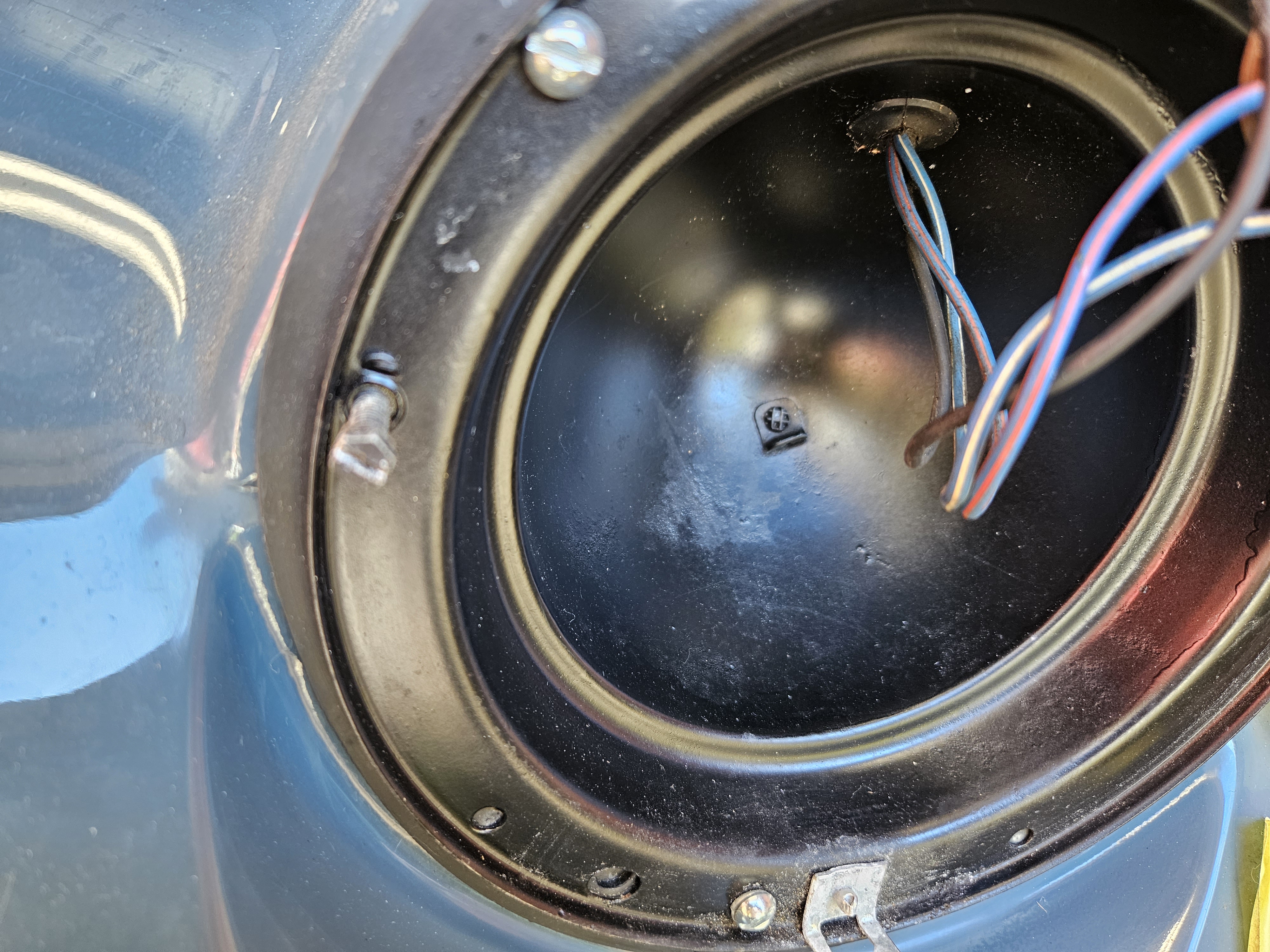

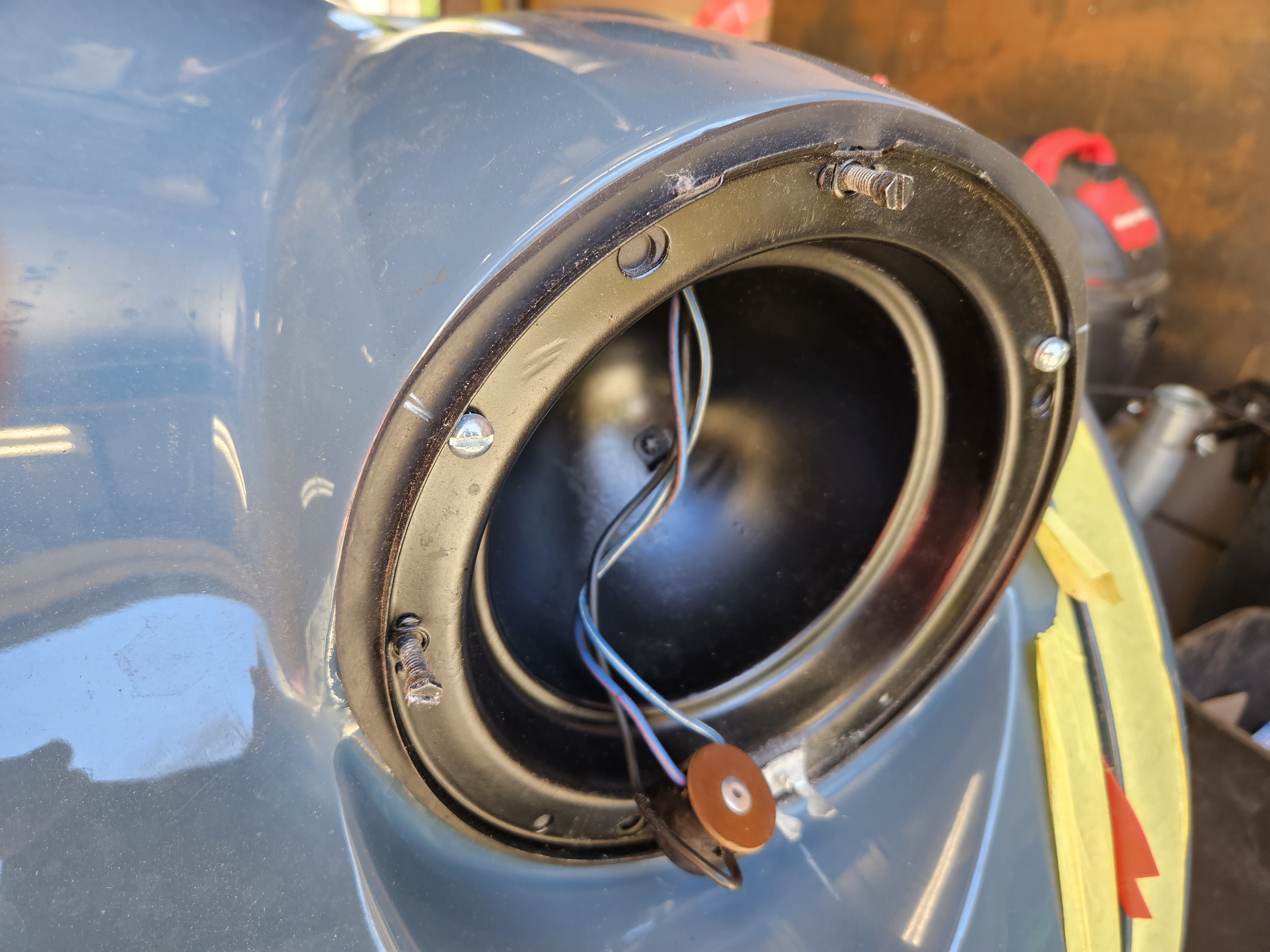

HI Folks.. Wow.. I may drive my TR this summer..after 7 years! Oh yeah, headlights. The buckets on my car only have two adjuster screws. Is that right? Been a long time. I don't see how that can work. The lights just flop around. Also, what is that little tab toward the back of the bucket. My car is a 60 model..TS 78***.
As an aside, was the solid rear bench seat standard or an option? 20230413_160023[1].jpg20230413_162637[1].jpg

Congratulations on your perseverance! Two adjusters is correct, but there needs to be a few more parts to make it work. A spring hooks to that tab and pulls an inner rim, which keeps tension on the 2 adjusters. See parts 19 & 20 in the Moss diagram:

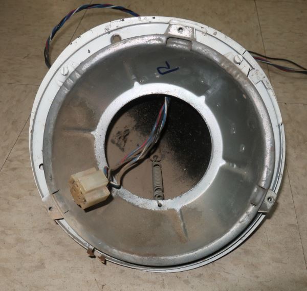

Sarastro, thanks for the picture. They really do help..you know what "they" say...
