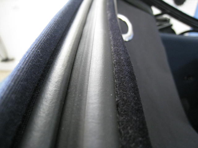

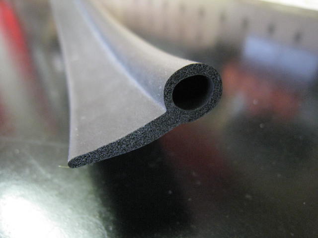

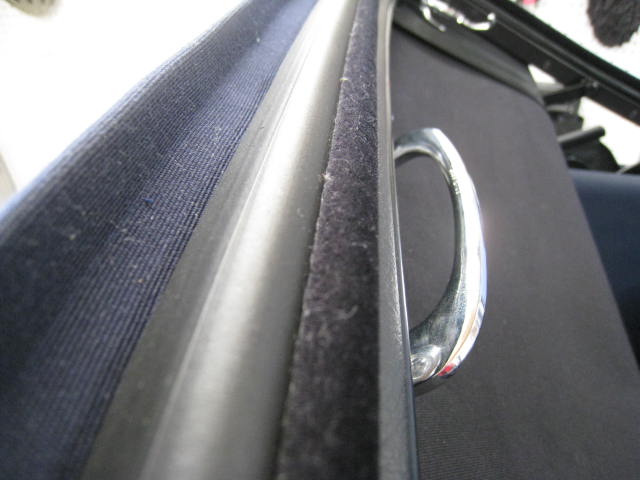

Hello BJ8TONY,
There is a piece of rubber that goes in between the furflex press on rubber piece and the front lip of the aluminum header rail.
That rubber piece has a flat section about an inch wide and a bulb at the edge. The flat rubber section goes under the furflex rubber bulb. The bulb of the flat rubber, presses against the edge of the furflex bulb.
The rubber should be glued in place, but may not need be. I pressed mine in place, under the furflex, to see if it made a difference vs not having one. Mine stays in place with out glue. I have a cloth top, and maybe the material helps keep it in place, versus everflex which is smoother and no real texture.
1. shows the rubber piece
2. shows where it goes
3. shows it in place
