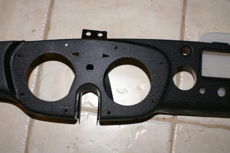

VHT is a pretty good brand. I've used their wrinkle finish paint on the GT dash and valve covers with good results. Sure can't hurt to try it. Let us know how it works out.

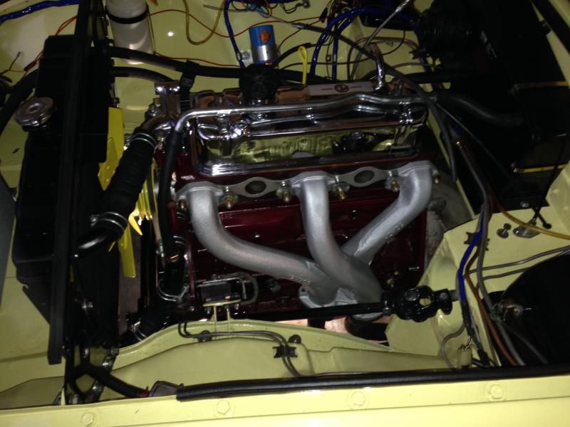

Joe,
I used it on my MGB exhaust manifold and I had access to a curing oven. I doubt there would be very much difference between the two methods of curing and I'm very pleased with the results.
Rut

If you have a fireplace, hang it in front; that's what I did with the dash and valve covers. Came out perfectly!

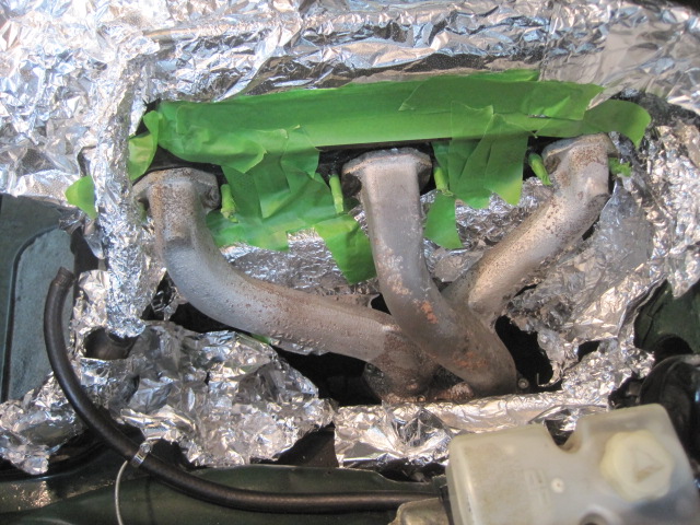

Painting is done. Here's the "before" pic (I forgot to take one before I started masking). The paint that was on there was done 12 years ago, most likely with whatever silver VHT paint that was available at that time.

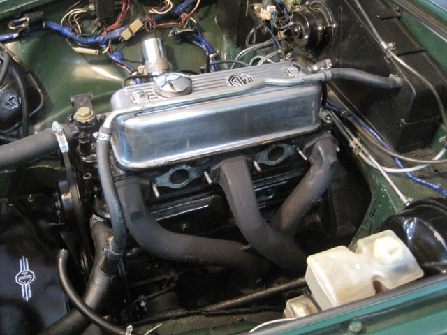

Here''s what it looks like done in flat black (ignore the dirty engine compartment).

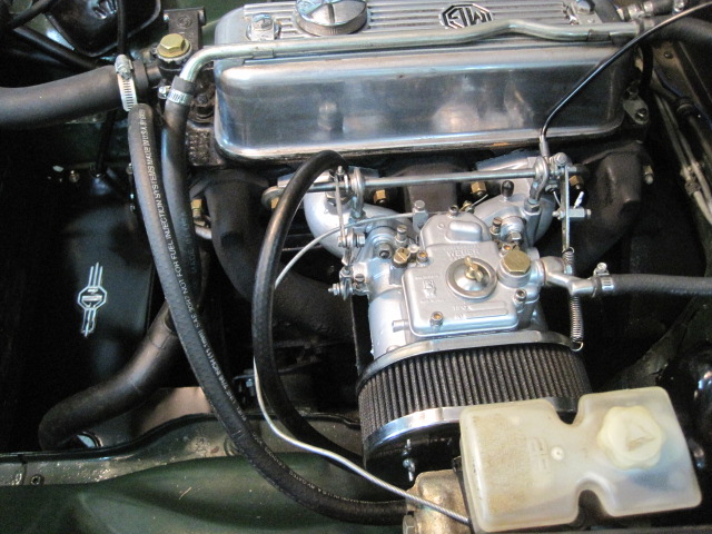

And here it is with the intake reinstalled. I like the fact that the flat black pretty much makes the exhaust manifold disappear.

Tha cleans up the manifold nicely. Well done. Will be curious to see how it holds up.

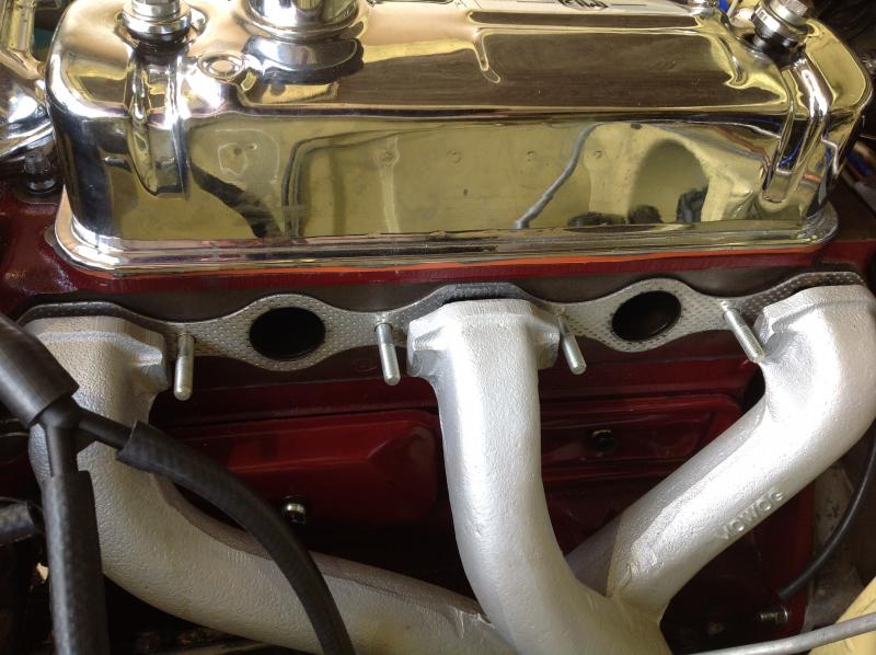

Joe,
I love the VHT paint and it holds up really well. I sand blasted my exhaust manifold and used the curing process in a powder coat oven at a local shop.
Rut
