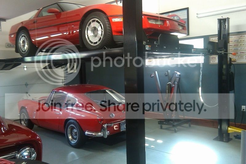

I, too, went with a 4-post -- for me it was the best solution for both working on the cars and for storage of 2 in one space.
It was delivered to my garage (quite reasonably) and I had a crew standing by for a quick unload and then assembly. We got the 8 big pieces put together in a few minutes, then pizza and Guinness all around. The rest of the assembly (cables, hydraulics, etc) were easily done solo the next day. That work is easier if you assemble the big pieces with the ramps raised up to the first notch (while you have all your help there).
Before assembly I had everyone sign the bottom of the ramp (including the FedEx driver):

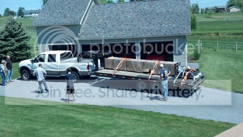

My choice was the Direct Lift Pro Park 9S 4 post lift with two rolling jacks. Had not only the Triumphs in mind with the decision, but also the daily drivers and my other old car hobby addictions. One caveat: After seeing what others had to say (mostly on the garage journal.com), I wanted a lift that was ANSI/ALI certified. In hindsight, I have no regrets with my purchase other than...I should have done it years sooner. I had it shipped to where I work part-time, then trailered home by a friend for small dollars and beer, then assembled with the help of envious friends who are still taking advantage (not really) for the assistance provided. Here are some photos.
We used the engine lift to unload the heavy pieces from the trailer (the runway holding the lift cylinder weighed 800 lbs).

I was guessing that his ceiling was 142" -- FWIW I am 5' 9" and my ceiling is 117" where it matters (top of the windscreen) and that seems to me to be the ideal height for working under the car. This is one notch below 'full up' on my and many similar 4-post lifts.
DNK
George , post that pick of your garage again.
Now that I know it is 117"
