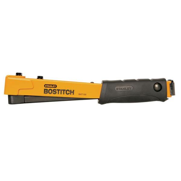

I bought a staple hammer to tack up my radiant barrier material. I do have a staple gun but I figured my hand would be numb from all the "squeezes" of the trigger. Just swing the staple hammer to contact the wood and it's done.
