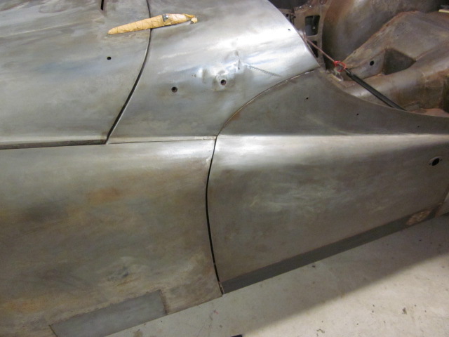

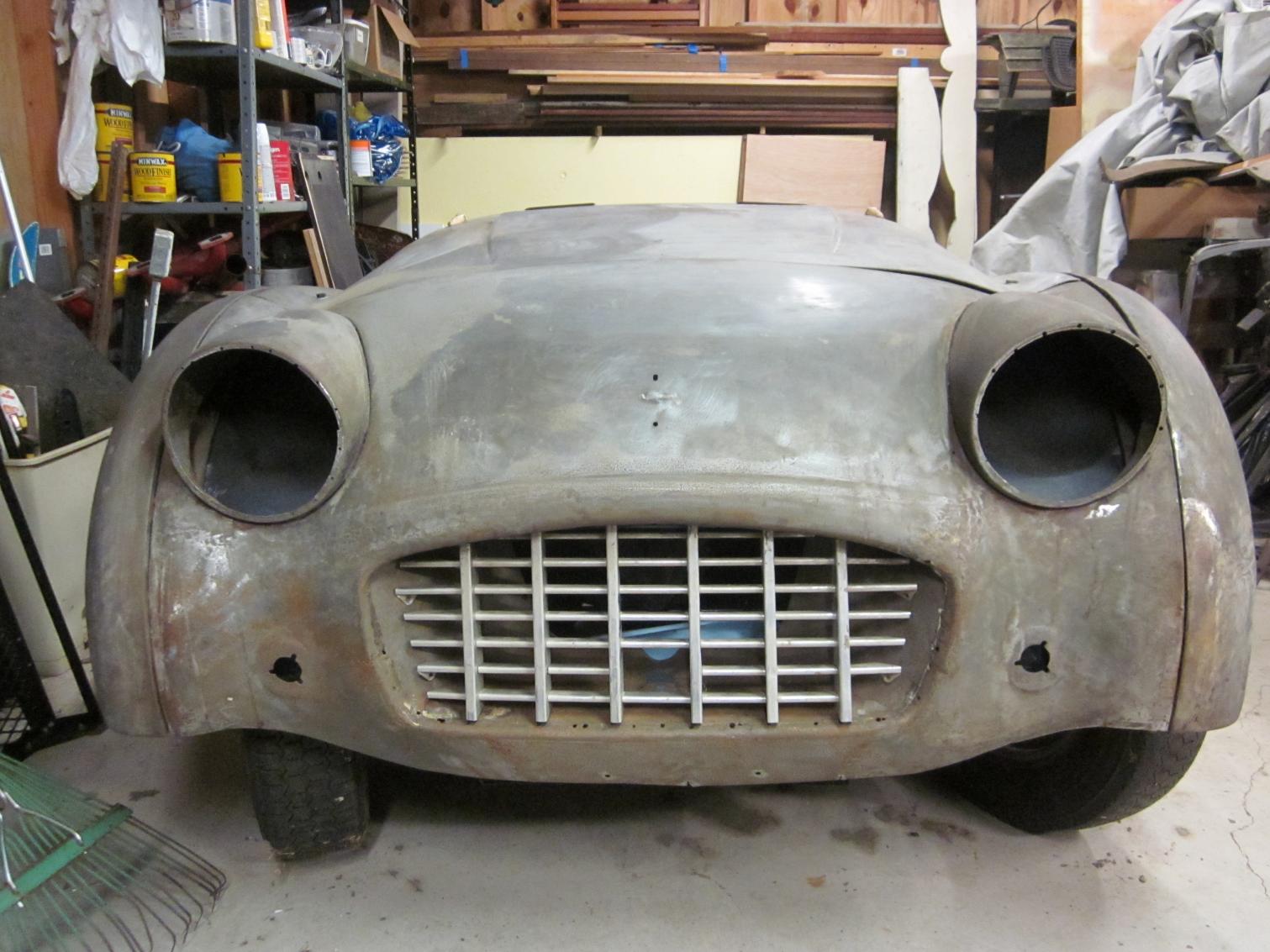

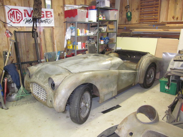

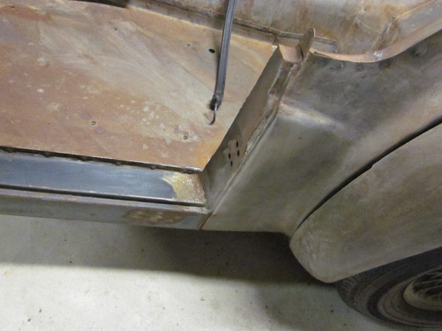

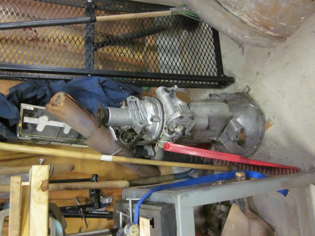

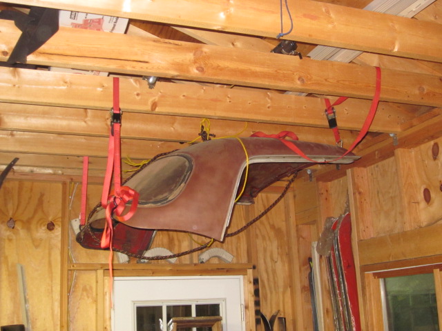

I bought this back in 1990. I worked hard on it for a few years and then got busy with life. This is the third garage it has called its home under my watch. Along the way I found an TR4 OD trans and a hardtop. Engine has the big bore kit and D cam. Lots of new parts.
Every time I uncover it I get the urge to start working on it. It appears to be in a stable state but I would love to get some primer on it to really buy me some time. Any thoughts?

Since it appears that most of the hard metal work has been done, I'd strip off the existing surface rust and get some primer on it. It actually doesn't look like you're that far off on getting the body done (lots of filling and sanding, but with the exception of a couple of small dings, the heavy metal work has been done.)
The fact of the matter is that the values of these suckers have gone up enough that it is very much worth getting the project moving forward. There are plenty of things you can do here and there: recover seats, get the head done (if need be)...just start moving forward. It will be an awesome car when you're done.
Any decision on what color you'll eventually paint it?

My time line on this project started over 20yrs ago. It started from a failed restoration attempt and here it sits again. I feel that it may have been scrapped if it were not for my work. I installed new inner and outer sills, rear dog legs, rear valance, front inner fenders and floors. It was is really bad shape.
After a good clean up of the steel and some metal prep, what is the best base paint to preserve the project to the next step? I have heard of self etching Epoxy Primer and POR15. I figure I can do a lot of the inner stuff without a lot of expensive tools. The painting thing and these primers scare the heck out of me.
It would be ideal to get some local shop or fellow car guy to prime it after all the dirty work.

My advice would be to take it to someone who knows what they are doing and have it stripped and primed professionally. I had mine mineral blasted, rust repaired and primed in a high build epoxy primer. It wasn’t cheap ($2,450) but in the end it saved me time and money while I worked away on other stuff knowing I had all the rust issues under control. I am on year 23 of the restoration project and still married! Also I created a restoration plan that outlined what needed to be done and identified if I would do it or if it would be done by others that really helped me organize myself.

You are at the cross roads and it's time to spend some money. Get the tub re-cleaned and primed. I'm sure the shop that shop that cleans the tub will know some local shops who can prime it. Then finish the body work and then its tub paint time. Here's a good starting point, there may be shopes even closer to you but this one is not too bad: https://www.stripitallblasting.com/contact.html
Load the tub up onto a rental Penske truck and away you go.... you might find this thread of interest (post #15) . WHile I went chemical stripping instead of dry, a lot of the steps are the same. https://www.britishcarforum.com/bcf/showthread.php?66091-TR3-Body-Stripping-Bare-QuikStrip-Allentown

I believe you have a diamond in the rough! Rule of thumb is that you need to buy the best body you can find as that is the most expensive area to repair.....you already have a GREAT LOOKING body to start with after your prev work. Today's paint systems are very complex . Be sure that each component will work with whatever "system" you choose .....1 part, 2 part, epoxy, etc. BE VERY CAREFUL as some are not compatible with others and expensive paint work can be ruined if each part is not part of the "family". This includes primer, filler, paint, etc. You have done all the heavy lifting.....time to get it a set of new clothes and not look back......it will be a beauty!
