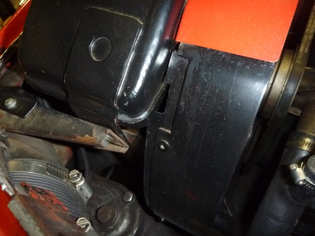

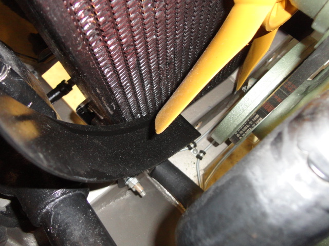

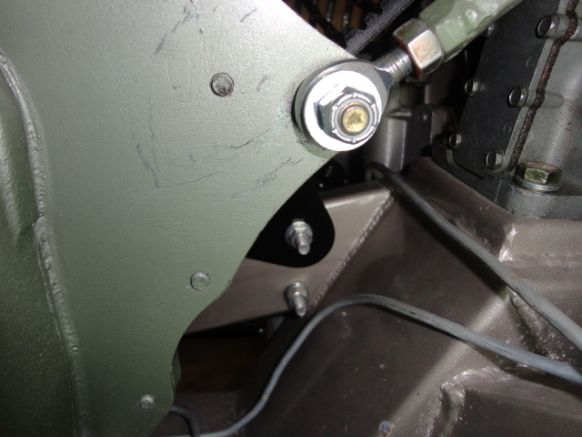

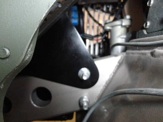

These are pics of my Kilmartin Fan Shroud installed on my BJ8 with Texas Cooler. Care should be taken when lining up the curve of the Fan Shroud with the radiator shroud because you don't want to stress any soldered joints on the radiator shroud. I bent the Kilmarting Shroud a little bit to make a smoother fit to the radiator shroud and used 10-32 screws to attach it.

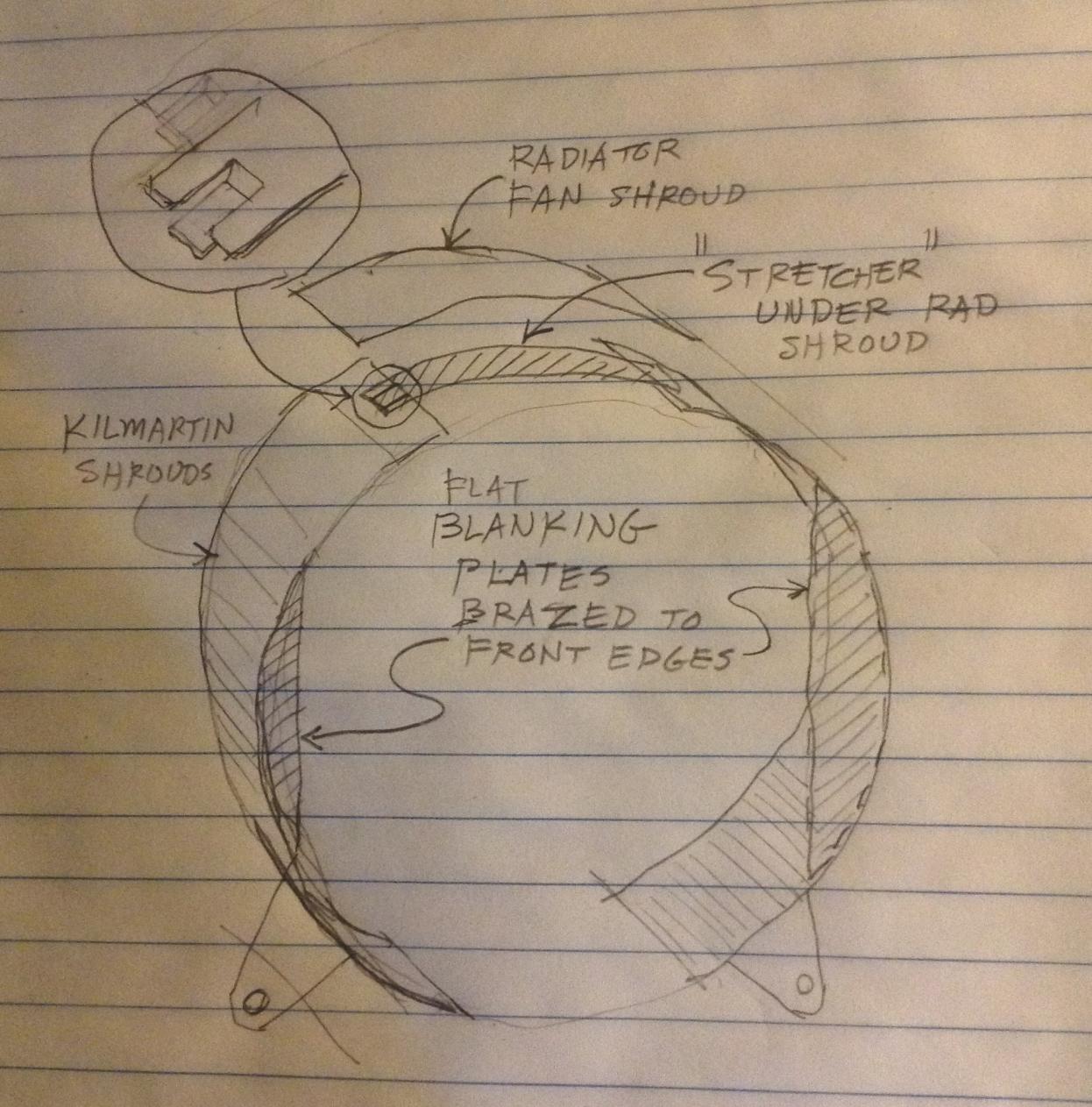

steveg
I used a sheet-steel 'stretcher' to hold the tops in place by pushing the tops of the Kilmartin shrouds outward against the radiator shroud as well as adding blanking plates to the parts of the shrouds that are outside the radiator:
modshroud.jpgapologies for the drawing - am sans car right now.
When I get back from vacation will post closeup pics of mods.

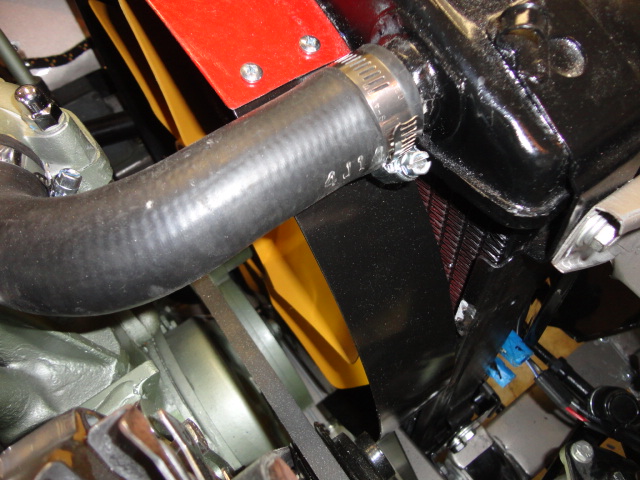

TimK

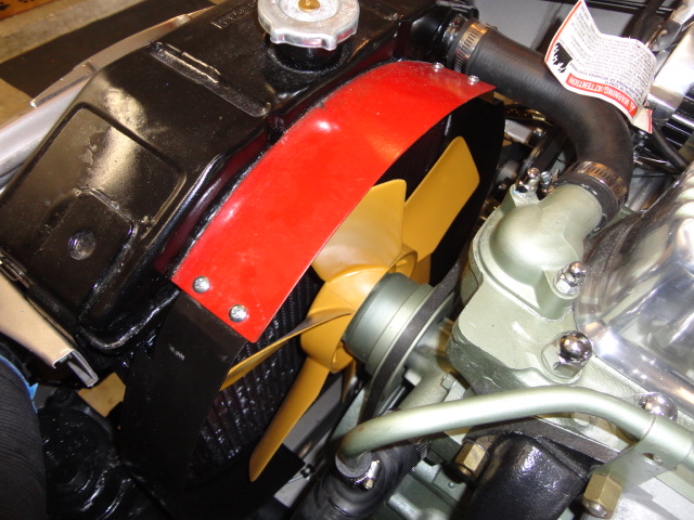

This is the photo of the BCS shield, I painted the left side red, the right side is black. I didn't know the BCS shroud came from Kilmartin, but it is well made and well designed. It attaches with a bracket at the bottom of each half to the lower radiator bolts. I added one screw at the top of the left side, but nothing else was needed on the right side. It goes over the radiator inlet hose but the bracket at the bottom keeps it very secure in place.
This pic also shows the BCS 6 bladed stainless fan which is not a flex fan. It works very well at idle or any speed.
Looks like a flex fan to me (though not as extreme as the Hayden BCS used to sell). You can tell if you note the thickness of the fan 'disk' at idle, then rev it up. If the 'disk'--basically, the blur made by the blades--gets thinner then it's a flex fan.

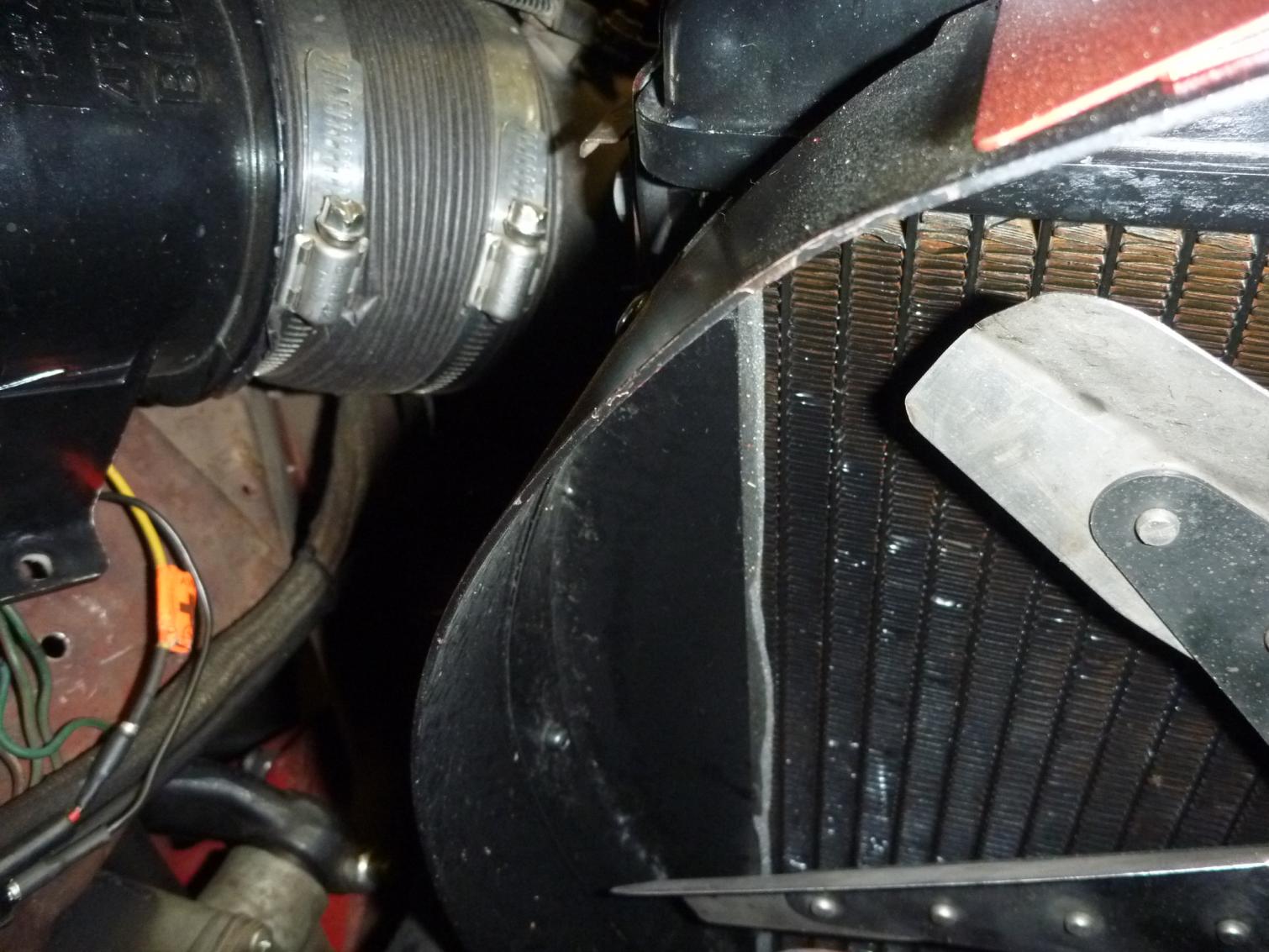

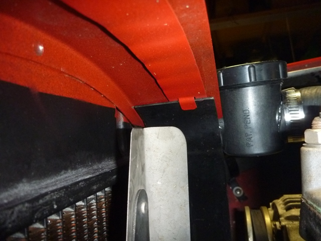

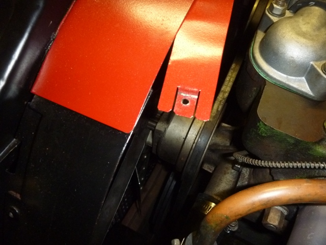

Pictures of modified shrouds:
LeftOuterUpper.JPG closing the gap to the radiator.
LeftInner.jpg Inside left view
StretchBarInPlace.JPG Stretcher bar pushes top edges against radiator shroud
StretchBarEndDetail.JPG Detail of stretcher bar end
UpperShield.JPG Upper front shroud (homemade - not kilmartin)
