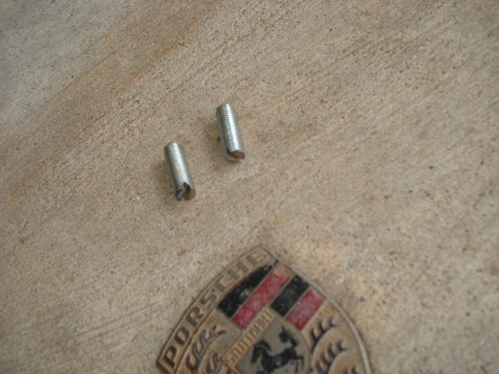

The screw plates are "captured" but they will still drop a little lower than is possible to easily screw in the door screws, especially when balancing a door at the same time. My trick was to make some short studs to install to act as aligning pins to prevent the plates from dropping too low. They are simple bolts with the heads cut off and a slot ground in the middle to allow insertion with a screw driver.

healeyblue, is the rest of the 911 buried in the concrete?
Hah! No, but it is actually the old emblem from my 928. I put that right after I poured the concrete for my shop 7 years ago. This BN4 was actually the first car put in my new shop. Jim
