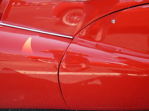

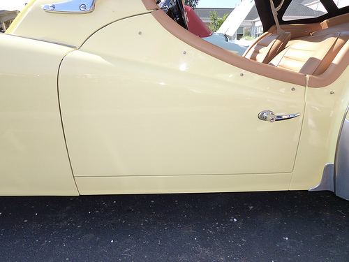

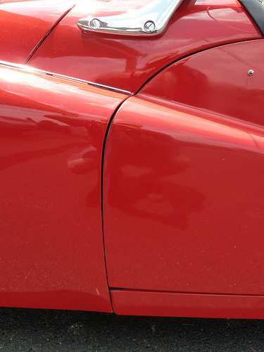

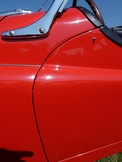

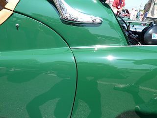

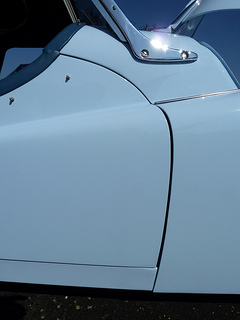

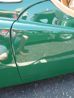

Ah, the old door gap question. I remember it well. Be sure to get this part right. Spend more time and more money here, because the quality of your build all goes from there. I went to the 2010 TRA to check finished cars as I was at exactly your point in my build. I took probably a thousand pictures of every gap on the cars. Some of these were best in show, some were drivers, and some were in between. As you asked specifically about door gaps, here is a sampler.
Let's just say when I got back I knew what I was not going to settle for and what the target to shoot for was. Good luck with the build.
PS - still learning the new board software - some of these click and enlarge, others don't.

Those are some great pictures, and worth more than a thousand words. I think the gaps consistency is more important than the actual width of the gap. -That is, the door should be centered, and the gaps on each side should be the same as the gap on the bottom, and about the same as the gap at the hood, rocker, etc.
It's easy to add/subtract shims under the hinges to move the door forward or rearward until the latch works properly. It's harder to move the fender, and even harder to move the rocker -especially the slight bend under the front of the door.
