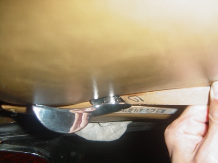

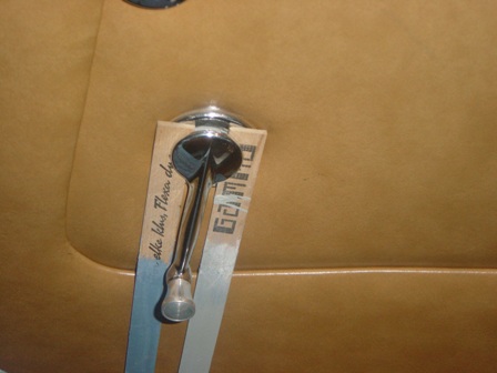

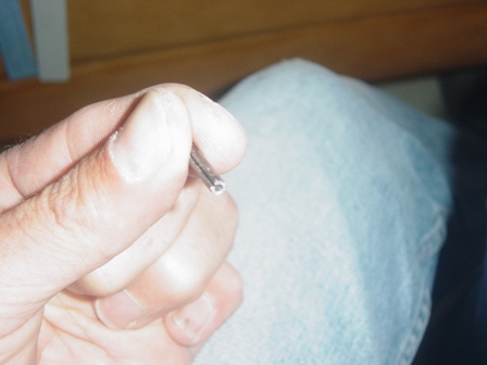

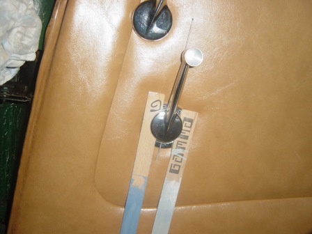

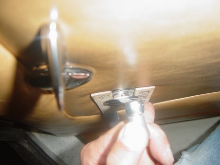

Pictures from a BJ8 Mk III (1967)
Wood is to keep things straight ... until the pin is out
On the roadsters the handle escutcheon can trap the pin if it's not pushed back enough. It has to be pushed back enough. Maybe wood wedges on each side might help, but the escutcheon is tapered, and so a fork to keep the wood from spreading would be better.
