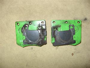

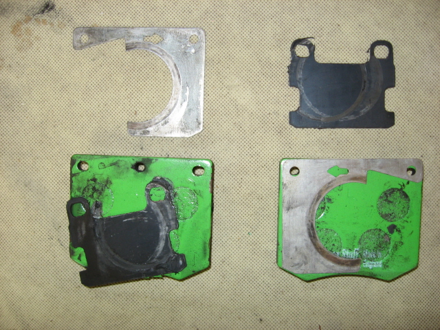

I changed to Green not too long ago and started hearing not a squeal but a sort of rubbing sound. I pulled the pads and found the backing pad that came on the pads had shifted off the center of the pad. There are no holes for the pins to hold it in place like the original steel anti-squeal shims. The glue got hot I guess - I went back to the original AS shims.
The car does stop better with the green, but the DPO pads were so worn anything was an improvement. I'll try to add a picture, but I'll have to resize. Cheers.
