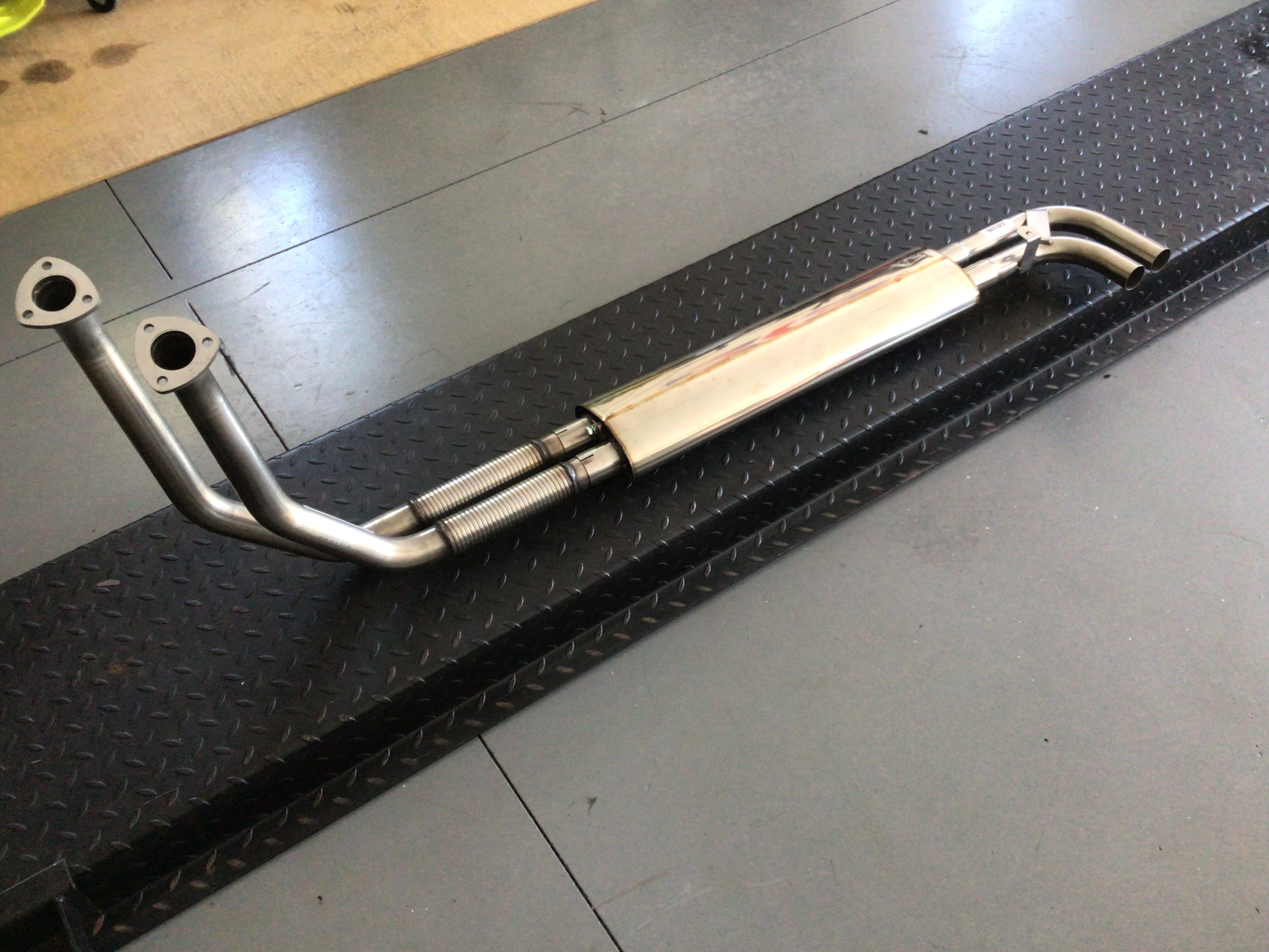

Here is my stainless big bore system from AH spares that is going on my Tri carb project rally car .
silencer is 26” long .
inlet 2” OD , outlet 1 3/4” OD . tubing size . The front pipes have a BELL label on them .No labels on the rest .
I would have preferred the side exit pipes to exit at a 45 degree angle as they did on my Stebroe system on my old 64 .
I may take it to a custom exhaust shop and have them alter it once I get it all fitted and tested .
