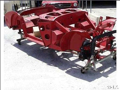

Dave Russell
Yoda - R.I.P
Hi Ray,
As I pointed out earlier, new cars did not flex & properly rebuilt cars do not flex. Many have rusted in the main structural parts & are weakened to the point where they DO flex or sag.
Unfortunately the body is not just "attached" to the frame. It is a semi unibody construction. All welded into one piece. The fenders, doors, & center shrouds are just lightly bolted to this main assembly. SEE THE ATTACHED PIC. This is what I meant by problems if it is mis aligned or sagging from rust weakened parts. Major parts have to be cut out & replaced/welded back. Fortunately, all of the structural sections are available as new from Killmartin, Jule, & such. Rust under a Big Healey is a major repair job.
