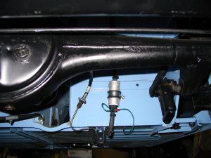

Well I got the pump all mounted up today and working. I wound up running the wire with the tail light loom and drilling a hole in the tunnel for it with a grommet. I also wound up drilling a hole and using a self threading bolt to secure it to the bulkhead.
Seems to work but sure is loud with no fuel to push just yet. Thanks for everyones suggestions!

Please post a pic of your installation... (and/or the installation in your 71)

Okay, you asked for it.
Hope it helps.

Lovely, nice install.
How come your rear shocks are painted black, supose to be natural.
