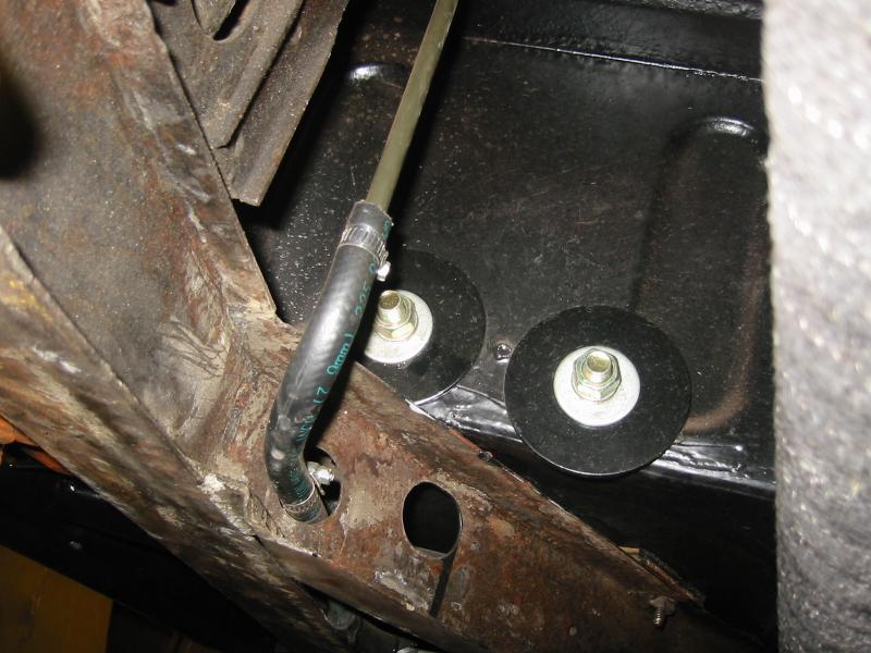

The attached picture shows the back side of the back shelf on my TR3. The large washers and bolts are where my seat belts mount. I am considering installing a Facet electric fuel pump. Since the fuel line comes out of the bottom of the fuel tank and Facet recommends that the fuel pump be as close to the fuel tank as possible and lower than the outlet on the fuel tank, there doesn't seem to be a lot of choices on where to install the fuel pump. I'm thinking of making a bracket that would be held in place by the seat belt bolts and then mounting the fuel pump onto that bracket such that the inlet into the fuel pump would be lower than the outlet of the fuel tank. Is this a safe place to mount an electric fuel pump? Are there any other options? Thanks!

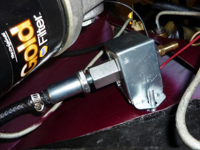

I mounted my Facet pump in the front left wheel well. It protected from all the weather, road salt, etc. It's been there at least two years with no problems.
Make sure to put some "insulators" under the mounting screws since it does make noise.

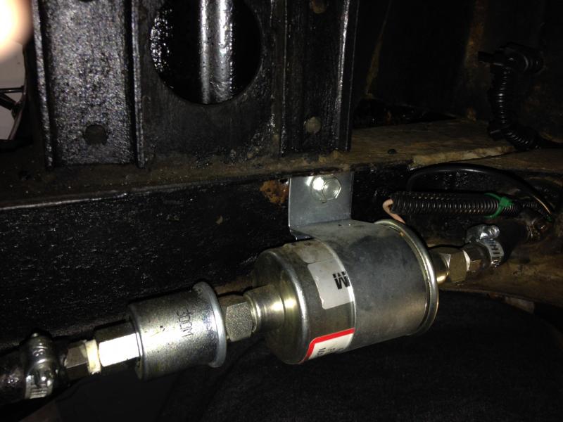

I installed a facet in the inner channel of the frame, right below & forward of the rear left shock absorber.
i had to cut down the flanges & I fashioned a "u" bracket that went from the top of frame to bottom, insulated with split fuel line. Worked great.........for 3 months, then failed. After that I went with an airtex cylindrical model & liked the fit much better.
i considered mounting on sheet metal, but these things do vibrate quite a bit, so I liked the frame install better.

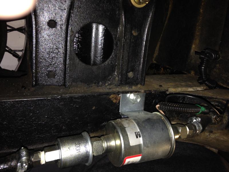

after the facet silver failed, I went with the airtex E8016s, ( good reviews & it was the lowest output I could find at 2.5-4.5psi). Though mine actually runs at closer to 6psi. It's also quieter
relatively inexpensive on Amazon at $30., I bought two & keep one in the trunk.
connected the unit with jacketed spades, for a quick exchange, if #1 goes bad.(heeding the lesson of the facet)
also it fit the spot where I had the facet, with no additional modifications.

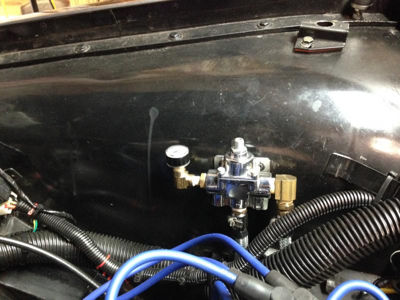

because of the higher than expected pressure, I installed a spectre fuel pressure regulator (also from Amazon , $25). Though I might not have needed it.

Thanks Guy!! That was a lot of good information and very helpful pictures. It sorta appears that Facet may have some problems and as a result several people have gone with Airtex.
