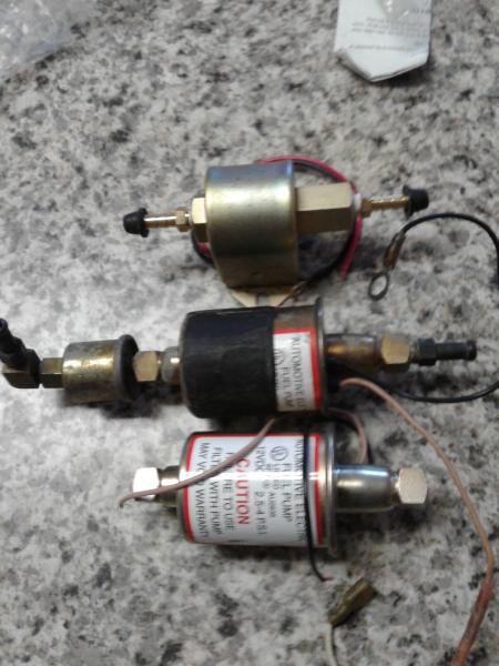

I am working on my friends TR3. He had one back in the day with an electric fuel pump. He says when he would start the car, he'd turn the fuel pump on and hear it go ticky, ticky, tick and then stop. He would then hit the starter. He wants a fuel pump like that installed on the car he owns now. I know this is a really strange question, but which of the currently offered electric pumps would be described as making a noise like that?

I'll try to dig out my pump and post a pic of it. It also ticked while running. My Triumph mechanic told me about it that he used it in MGs. Purchased it from my local Car Quest too for less the $20. Ironically it looks a lot like the one in another recent post for a back up electric pump. I did buy one as a back up for my TR6.

As promised. The pump in the middle is the one that ticks. The bottom one is the same as the middle one but I never ran it. There is a link for it on Ebay in another active post for an emergency fuel pump.
