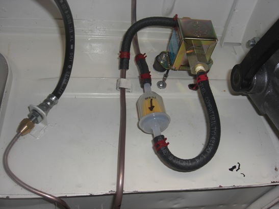

smaceng
This is what I did for my 60Frog......A couple of items to mention.....I believe that the Facet pump should have been mounted at an angle per the instructions (It is still running ok as far as I know after 5 years).....I mounted the Facet on rubber mounts to reduce noise.....it should also be noted that the bulkhead in front of the rear axle is doubled, so the install is a little more involved. I always figured that one filter should be enough. I know you have an SU, maybe you could use the mounting bracket from a later Sprite/Midget. PICT0009a.JPG
