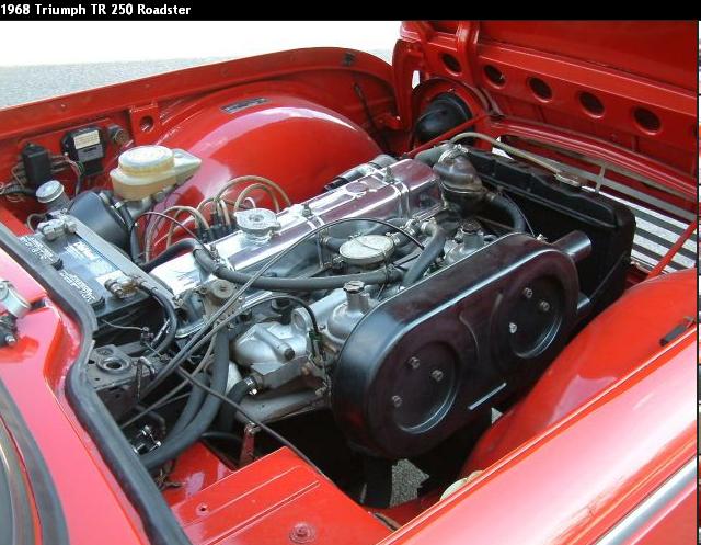

Possibly offtopic, but there is a TR250 on ebay right now - the pics show the release cable going to the passenger side, just like the routing on my TR4. Just curious if the 250 had a couple of different options on the hood release.
I've attached a pic of showing the release, it is ebay item
4630132445
Randy

Oops, here's the pic
Randy
