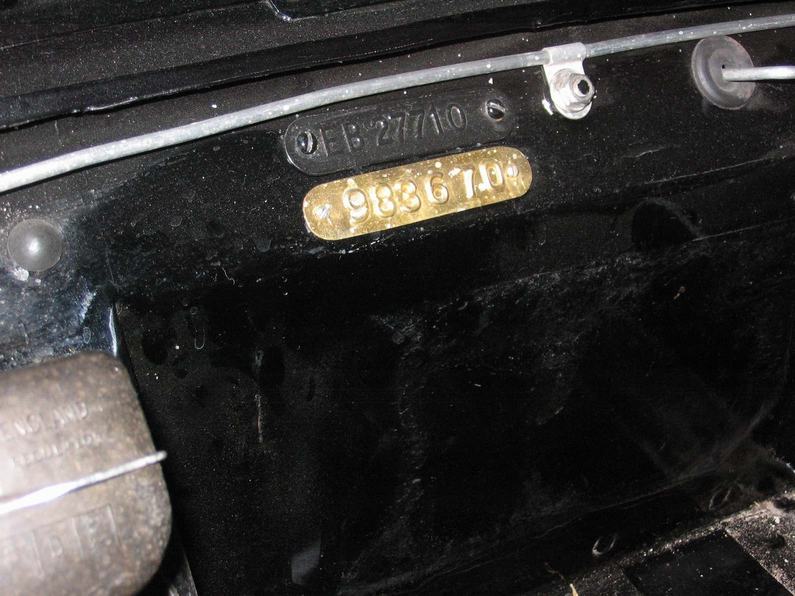

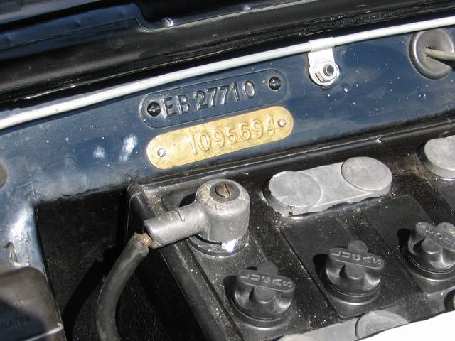

Don Elliott
That was the one I was using because my original one was corroded, but it was the wrong number. Here is the corrected new one.
