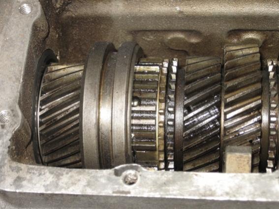

I just went downstairs in the basement where I have a TR3 gearbox that came out of the TR3 I'm now driving with a Toyota Supra box. I took this box apart and only refreshed it with new bearings and synchro rings with intentions of using it. It hasn't had any other parts replaced. The movement of both synchro hubs are little more then a 1/16" as nea ras I could measure with a ruler. Below is a picture of the hub while engaged with the synchro ring showing the exposure of the detent ball.

When together, I don't think the shift forks allow that much movement to allow the balls to pop up.
Ditto. The stops are in the top cover.

Thanks again for the replies.
Re the shift forks limiting the movement- the 1-2 shift definitely goes all the way and is evidenced by a wear mark on the side of the old 1st gear matching the shape of the engagement ring.
It seems like this is perfectly normal behaviour and perhaps a design that wasn't quite as well thought through as it could have been so I'll continue to reassemble the box and od once I hunt out a couple more gaskets and a tail shaft bearing.
