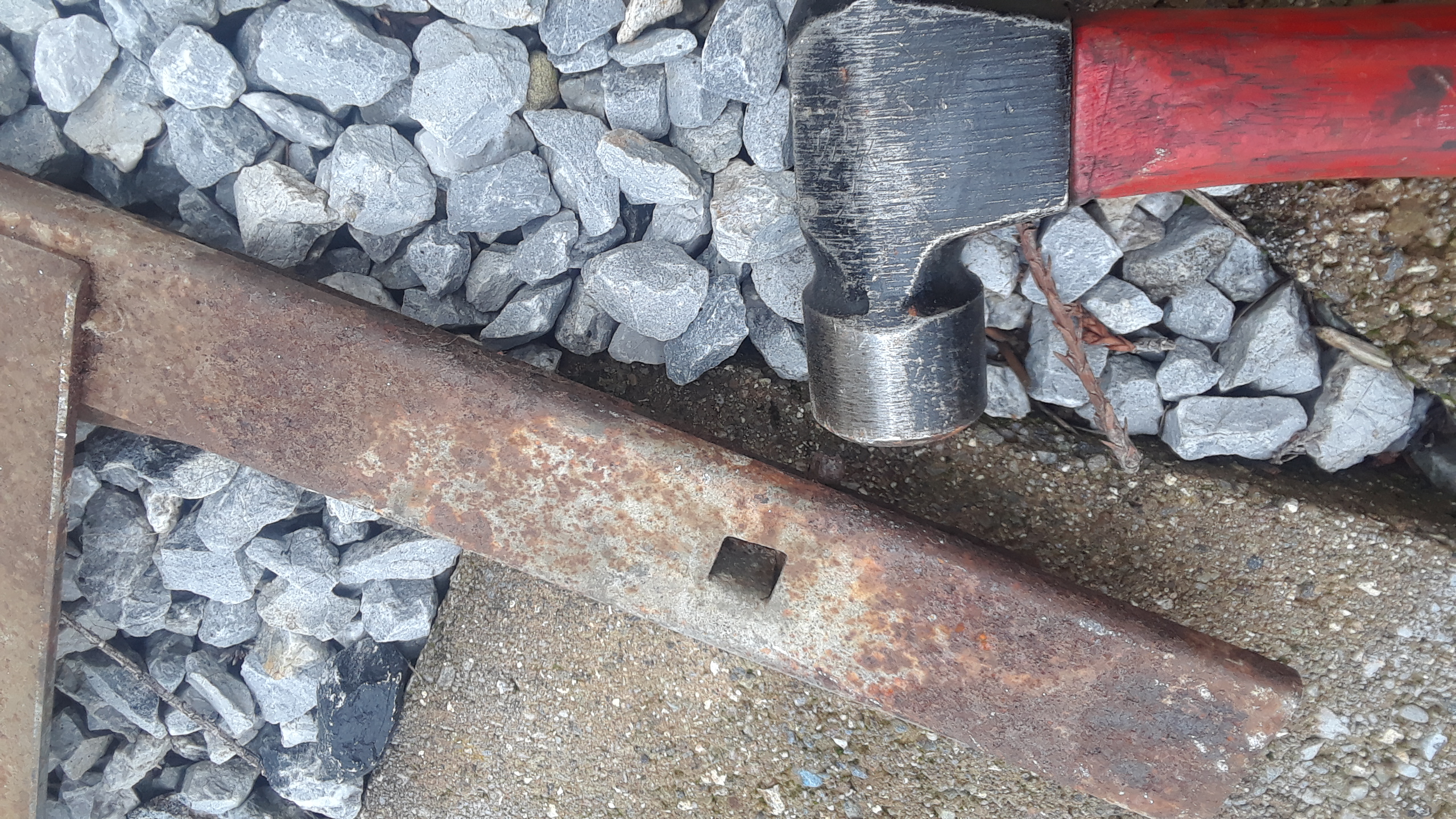

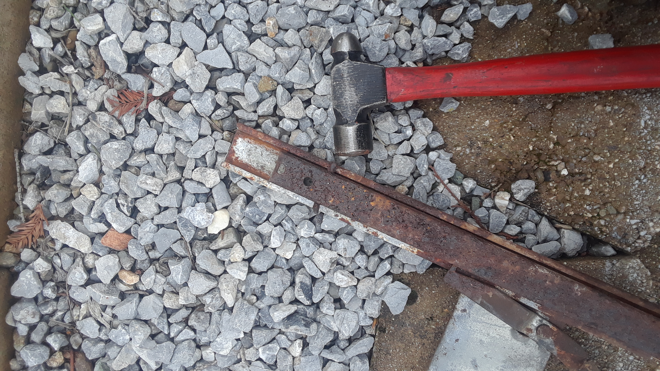

On the rear base part you will find a stop. On old ones it is a cotter pin and a bent tab. I will attach a pic of these. On the newer base/slider it is a dimple . On the newer one I drilled out the dimple. Of course on the older one you have your choice of which part to remove. This allows the seat and sliders to move to the rear. You will have to determine how far you need it to move. You may need to drill a hole for the lock mechanism on the one side.
You will also need to move the sliders forward on the floor.
I hope this works for you.
Charley
