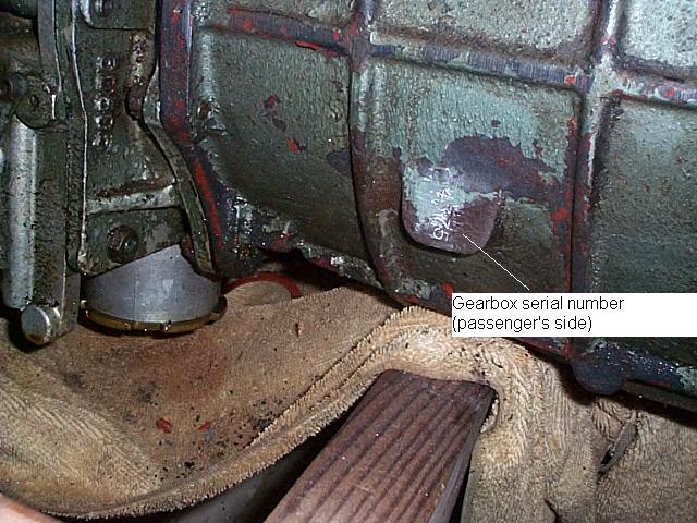

The easiest way to check the gearbox serial number is to put the car up on jack stands or on a lift. The serial number can be seen from below the car, on the passenger's side (LHD cars) as shown in the attachment.
