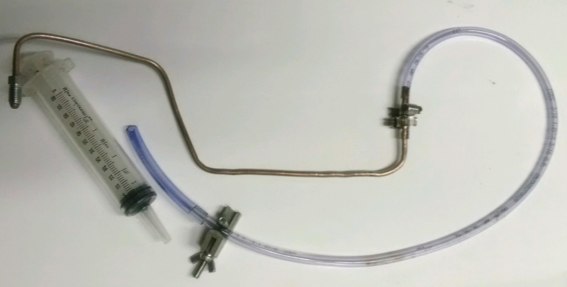

Thanks to Randy for his recirculating bleeding technique. I adapted it for an in-situ bleed of my recalcitrant Fiat dual MC.
Added the long clear tube to observe the bubbles.
After bleeding the MC, very little line bleeding was required to get a solid pedal (Dot 5 fluid).

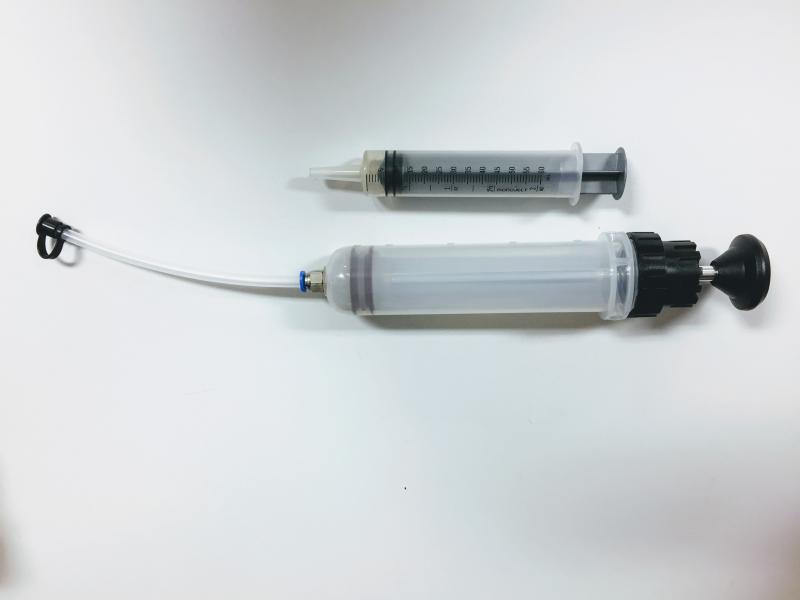

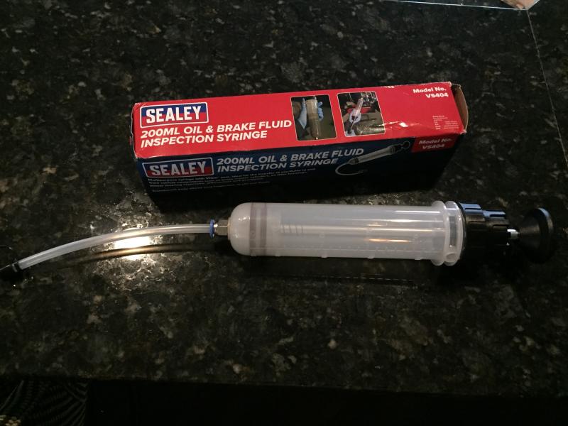

Hi Steve,
As you know I use your syringe method for bleeding brakes and clutch and like it. The only down side I experienced was that on initial bleeding when you don't have fluid in the pipes, you have to "empty" the syringe of "pulled" air several times, since the syringe is only 60 ml. I just came across this Sealey syringe made in England that holds 200 ml. I ordered it and found it to be very high quality. I like it a lot. It can also be used for "pushing" fluids such as filling a transmission or a rear differential. Check it out.

Hi Steve,
Lin
That looks super useful!
