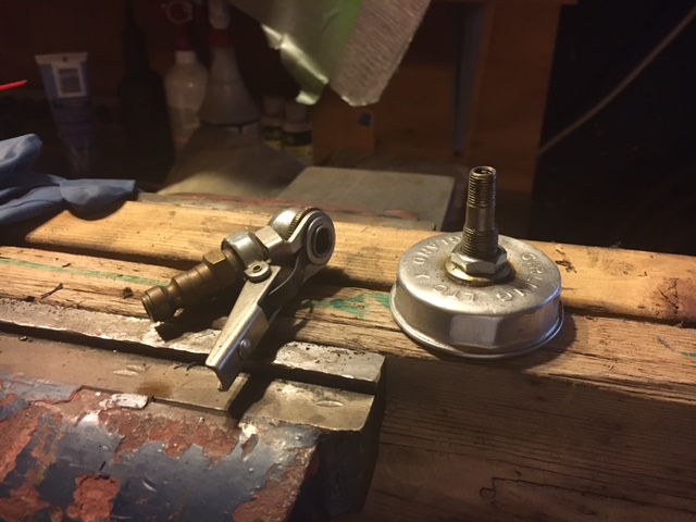

Did Norman give a reason? My pressure bleeder works a treat; you just can't use anything over about 10PSI:
