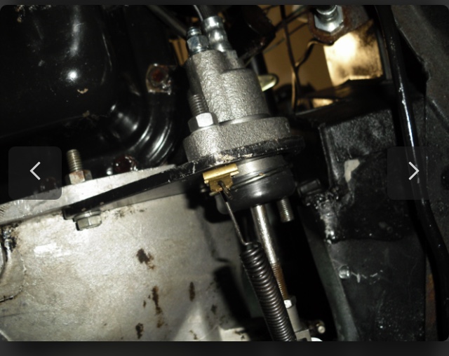

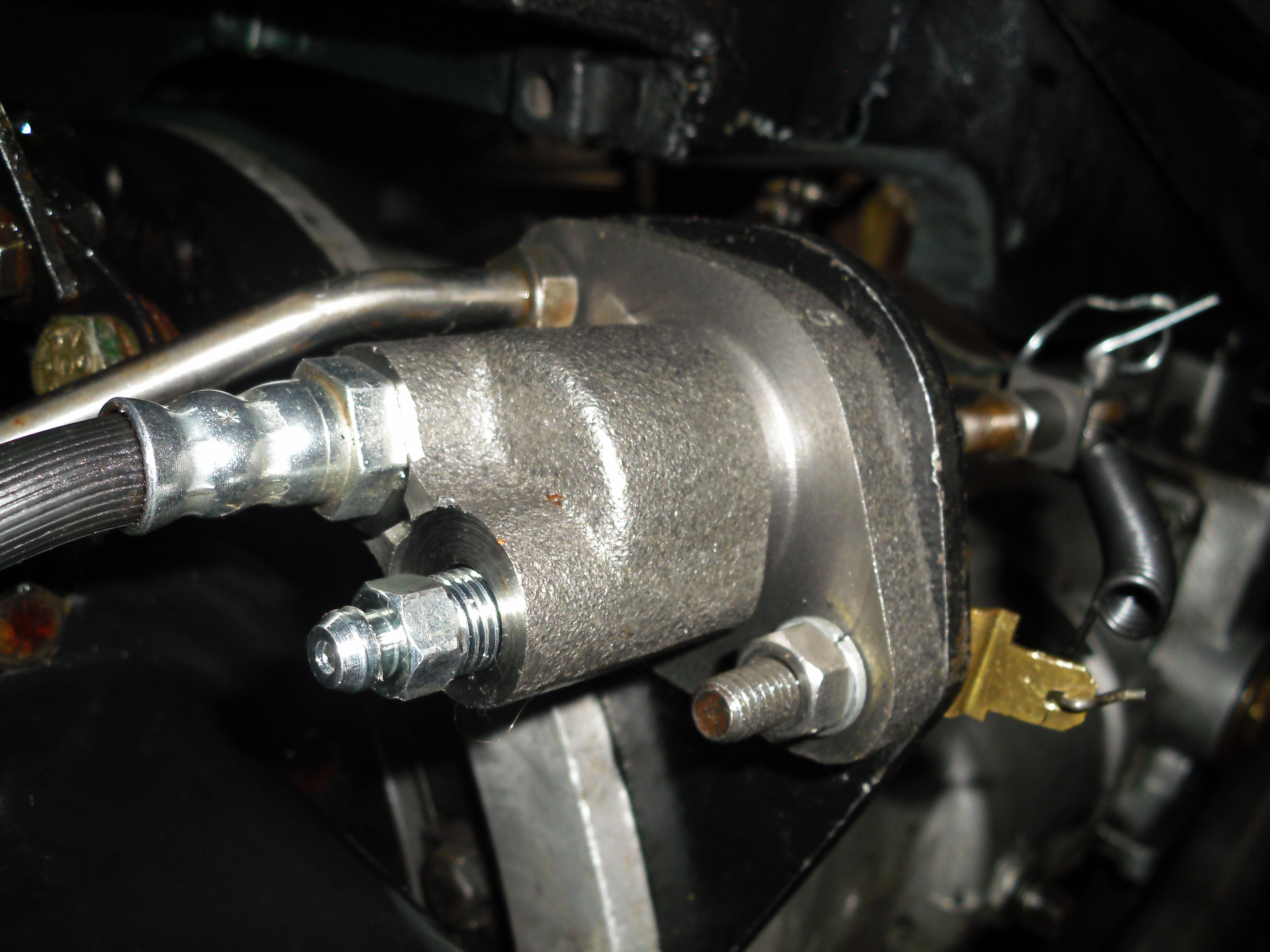

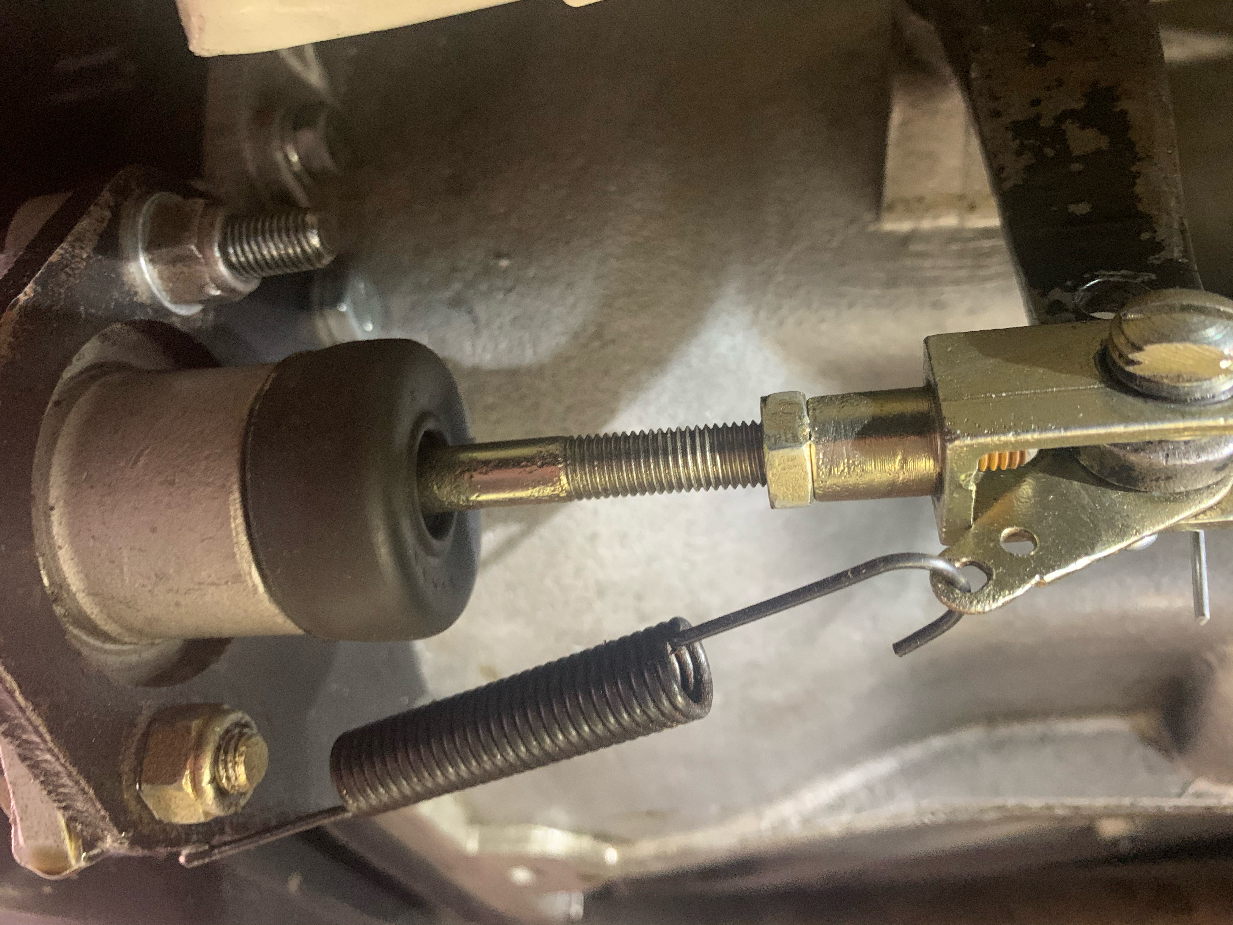

I just noticed something i installed wrong. The slave cylinder should be on the other side of the black plate.

Well you have been successful posting images. That can happen with the install on the wrong side of the mounting plate. It makes a big difference to move it to the other side. It is strange that I have another friend with a TR3A who was very recently having similar problems with the tight spring and push rod. He had done the same thing as you with the mounting of the SC. You are not alone. Remounting may solve you issues.
Frank

You need to fit the pushrod to the clutch lever and adjust to the workshop manual specs then with the spring fitted the piston will be pushed all the way into the slave cylinder and you can now bleed in the normal way with your assistant pushing on the pedal. I notice you have a tag on one mounting plate bolt with the spring attached to it, there should be a hole in the plate for the spring to fit into? so no need for the tag.
Graham
