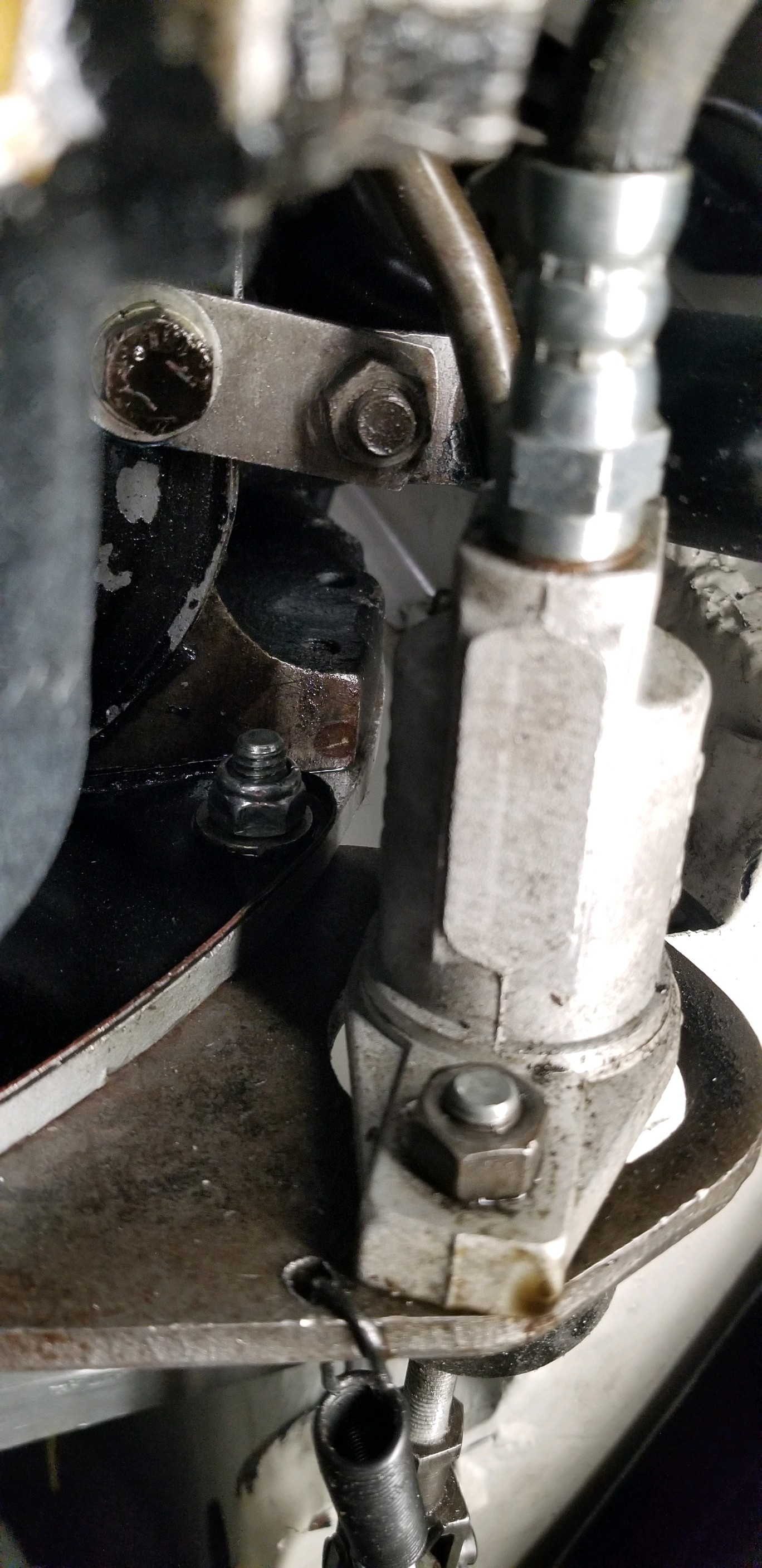

In this pic, is the piston all the way in?

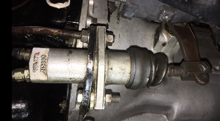

That's the one that came on it, and the new one is identical. The only difference seems to be the length of the rod; one is about 1" longer. It appears, in your pic, the the clutch level is almost at a 90 degrees up and down, assumes the piston is all the way in?
I will turn the cylinder around so the nipple is at the top, and will put the tag on the other end of the rod.
Hopefulyyyyyyy, it will then engage the clutch??
Dick
The position of the slave changed over the years...and is only important so that the length of the rod matches the mounting position of the cylinder.
The slave cylinder MUST be adjusted before you bleed. To adjust, the rod MUST be pushed fully into the cylinder until the piston in the cylinder is bottomed out completely. While holding the rod and piston bottomed in the cylinder, you then turn the adjuster to set the play on the link to the clutch arm. As long as you can adjust the play to the book, you are good and can move on to bleeding the cylinder. If you cannot properly adjust the rod link, then you need to change the cylinder mounting or change to a rod of the proper length.
When all is assembled and adjusted, the system will bleed itself with no pedal pumping. Just loosen the bleed valve and gravity will bleed the air out. If it does not bleed, then something is off with the slave or master cylinder adjustment/assembly.

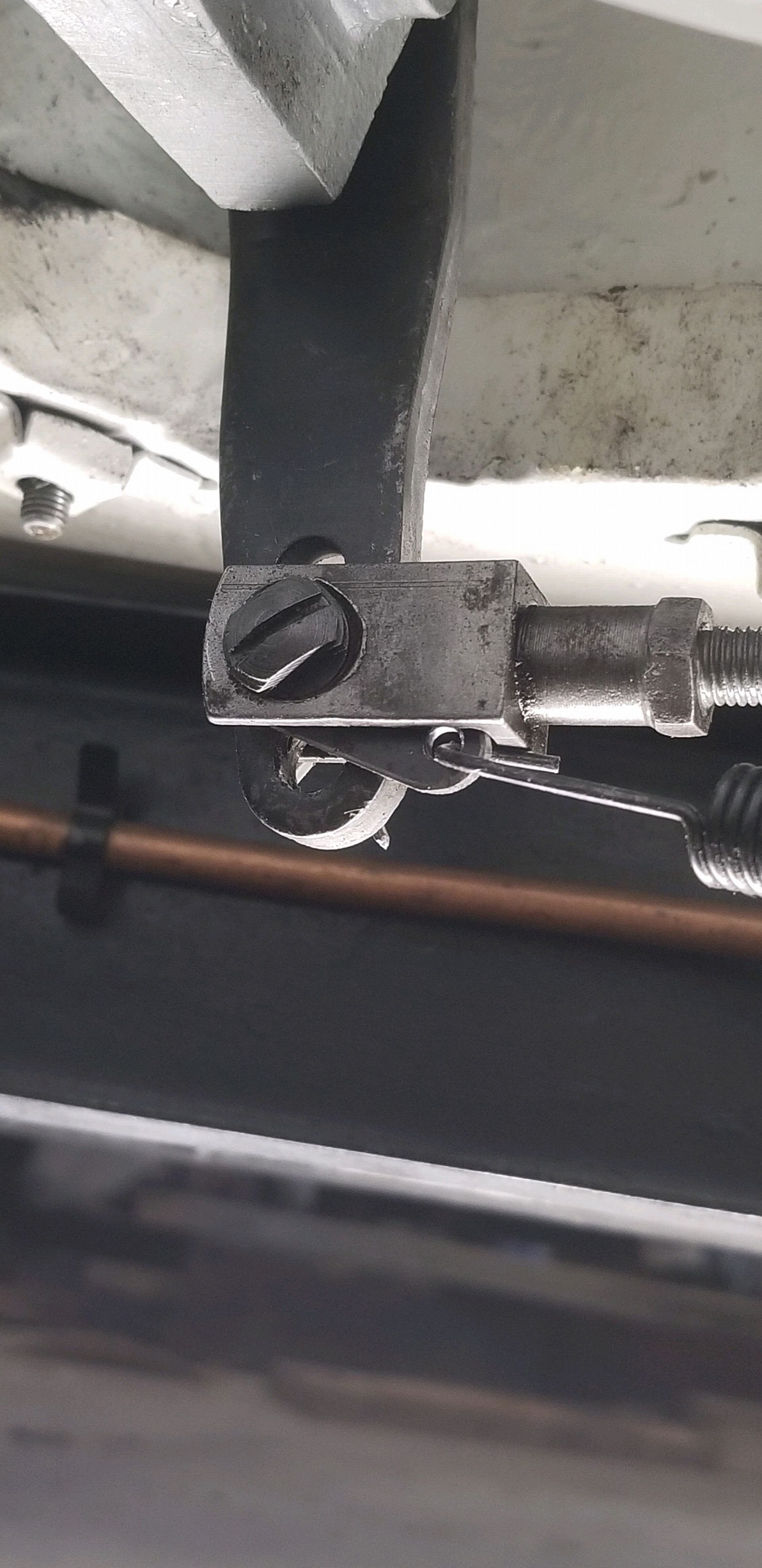

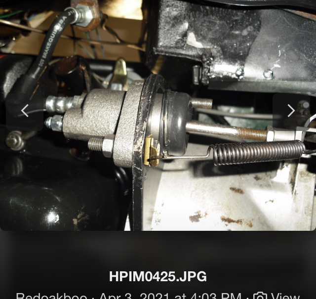

Dick,
You don't seem to have the spring anchor leaf washer on the leaver pivot, see my first photo. If you can find one or make one then fit the other end into the hole in the mounting bracket the spring will sit straight and have the right effect, just a thought.
Graham

Today I will flip the SC and reattach the spring clip to where it is supposed to be. I know you are tired of handling my problems; but I would be out of luck if it were not from the Brit Forum.

I flipped the slave cylinder, put the spring tab up front and installed the shorter rod. I now have it set with the rod all the way in and the spec. clearance. I had my helper "Polly The Pedal Pusher" push up and down, with a attempt to bleed the system. I am getting alittle air up and down the tube, but I am not moving the lever at all?. The pic shows the rod bottomed out in the cylinder. I don't understand why the pic will not attach. The pic specs are the same as the earlier 3 pic's I attached?

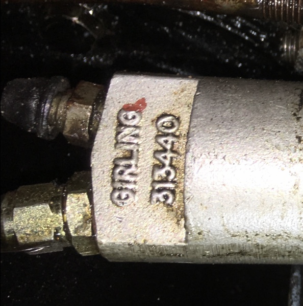

I’m still convinced that the slave is too small.
this is your that you posted ( I think)
This is mine
1959 tr3a
This is mine
1959 tr3a
The one i removed, which came on the car, looks actually like the one I purchased from Moss?

As just a brief commentator on this thread, I have ben following closely. Today was start up day for my '59 TR3A (TS42756L). Before start up I was inspecting the SC. I had suspicions about the spring. I do not have a spring on my Slave Cylinder and do not remember ever having one. I have logged 50,000 miles on this babe with no issues. Should I worry about the spring?
What keeps the clutch lever from returning to it's non-contact position, if you don't have the spring?
I have it in the center hole. Here is a shot of my SC to give an idea of size. Photo taken before I had the oil leak fixed.
David
Center hole is standard.

I started using the middle hole but as you say it sites at an angle and looks odd. The middle hole will give you more travel or disengagement of the clutch but it makes the pedal firmer to push so I moved it to the bottom hole.
Graham

Dick has the early Lockhead slave cylinder for the tr2 they are small like. The Girling tr3a is the bigger one, say 1958; the early Girling on a tr3a has a 1 inch bore and I think the tr2 is a 1 ÂĽ inch bore and overall size is smaller. The 1956 tr3 used the small early Lockhead. The tr6 and perhaps the late tr4 went to 7/8 bore that looks like a tr3 in outward size. I tried a 7/8 bore for a tr6 once on a 1958 tr3 but it took a lot more pressure to push down the clutch, but the clutch worked better. I went back to an inch bore because I liked the softer pedal.
Anyways Standard Motors played with the hydraulic clutch leakage a lot and they worked, but were different. I am not sure on the rod length.
John has the small one on his tr2; I have seen pictures of Johns. Stay with it Dick, and I think John’s suggestion are spot on; his works.

The floating question is Will it work without the spring? I don't see how the lever can return, back to piston, without the spring?
