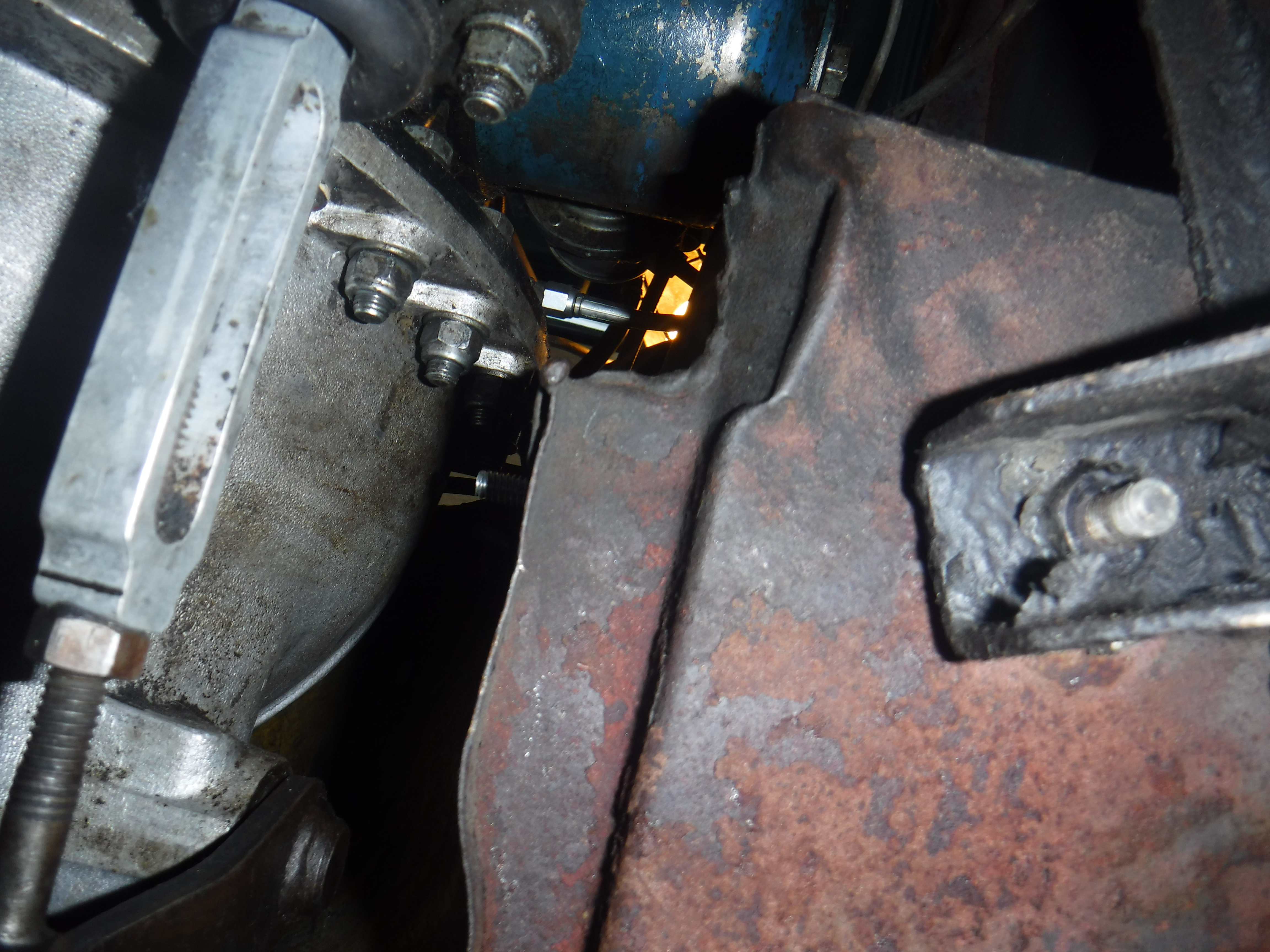

Pic 1 added turnbuckle to adjust to max travel SC on motor side of plate

I'm sorry, I don't understand the pic?

When you mount the SC on the motor side of the plate that adds 1/2 inch that needed to get max travel to clutch arm so you may have to extend shaft. I cut the shaft and threaded cut shaft end at clutch pin end. rounded the other end at SC same as supplied OEM. I then could extend rod to required length. This mounting allows one to remove SC without taking the HY line off and you can bleed line without pumping peddle. Just drop down SC and easily open bleeder until no air is seen tighten bleeder and remount SC. The bleeder must be on top and can be hard to work.
The math is as follows; your Master cyl is 1 inch bore the SC in 3/4 inch bore. so one inch of master Cyl travel equals 1 1/4 inch SC travel you need every bit of that to disengage clutch. The above pic by others shows mounting. NOTE the early TR had a 3/4 Master CLY and 3/4 SC

You reference a pic I can not find?
