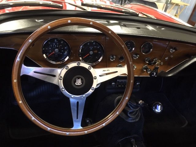

I have a Moto-Lita on the BGT, and one from Moss (Tourist Trophy?) on the '73B, both walnut. They are 14", and I didn't notice much, if any, difference in steering effort from the stock 15". So far no issues with marring; if they ever would get scratched, it should be an easy fix with sanding and refinishing.
I will say that the edges on the spokes and holes on the Moto-Lita are a bit more rounded than the TT's, if that makes any difference to you. A bit nicer finish on them.

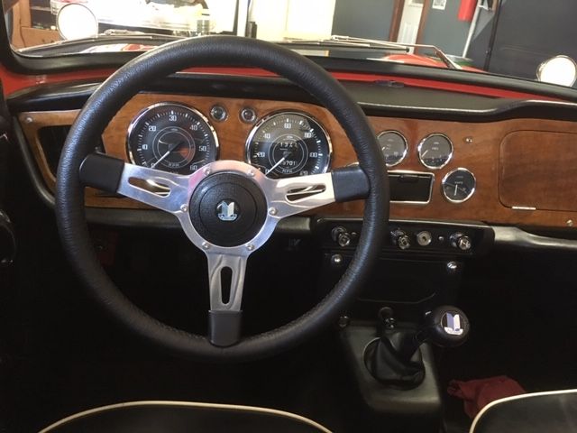

Here are a couple of things you might want to consider. When I first climbed into my TR4A, I couldn't help but notice that the installed 13" wheel by the previous owner narrowed my view of the tach and speedometer gauges...I just didn't care for how the small diameter rim "framed" those gauges. So I replaced the 13" wheel with a 15" Mountney (picture below). While the one I chose is leather, Mountney is a cheaper but well made steering wheel and they also make wood rimmed ones. Plus here's a good company that sells both Mountney and Moto Lito wheels... good pricing and they ship quick too: https://www.europaspares.com/interior-parts/steering-wheels.html
For the GT6, I did go with a Moto Lita flat 14". You then have to choose between slotted spokes or holes, and flat or dished. I chose flat with slots. When I installed it the rim came too close to the turn signal and light stalks...my fingers would actually hit the levers. Thankfully I was able to bend the levers to give the clearance needed.

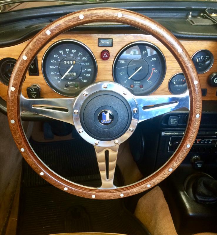

IMG_1940.jpg5Made my own from scratch because I wanted a better match to the other wood trim. A lot more work but am glad I did it.
Biggest mistake was keeping the 205 70 15 tires biggest improvement was going with 185 60 15 tires on the front,
