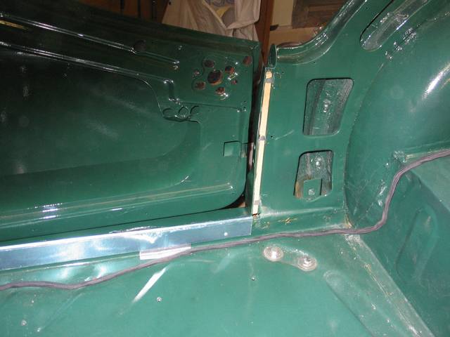

ekamm said:
I don't know whats in your Bpost but mine isn't wood. It looks like some sisal or twisted natural material of some sort...
Yes it is wierd stuff. Mine definitely needs replacing - it's pretty beat up looking and the right side tapers out to nothing - is an inch or so shorter than the left.
I was going to replace it with a fitted piece of pine but wasn't sure if that would be the best way to go or not. Anybody have any better ideas?
Don Elliott
Mine came new with the round wound up sisal rope in the "B" posts when new. I used soft pine for both the early and for the late TR3As that I restored. Works better and secures the tiny #4 slotted screws much better. You can hold them in with the same tabs you bend into place, But mine all broke of so I had to MIG weld new tabs to retain the pine strips. But I suppose the pine pieces could be glued to stay there.
