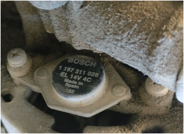

Trying to figure out which voltage regulator to buy.. Out of my Nissan Serena
it may also have the Bosch PN 3165143120255

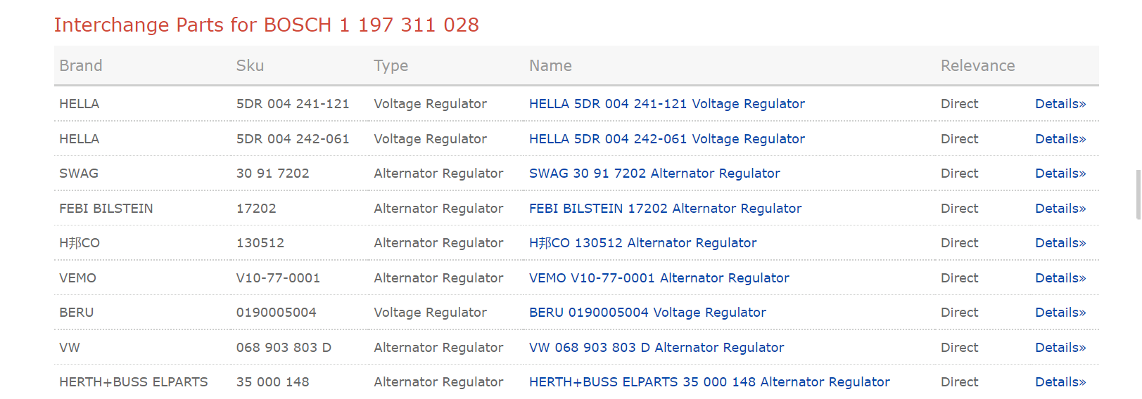

Think I figured it out. It is the same alternator as many Mercedes of the time... and following what Amazon claims works for the Mercedes.. ACDelco E675A came up with a bunch of compatible regulators - including the original Bosch.. So that does seem to be the correct and the Hella 5DR 004 241-121 or 242-061 should work according to this chart and Amazon thinks a few other versions will work on their compatibility chart.

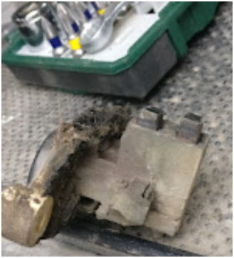

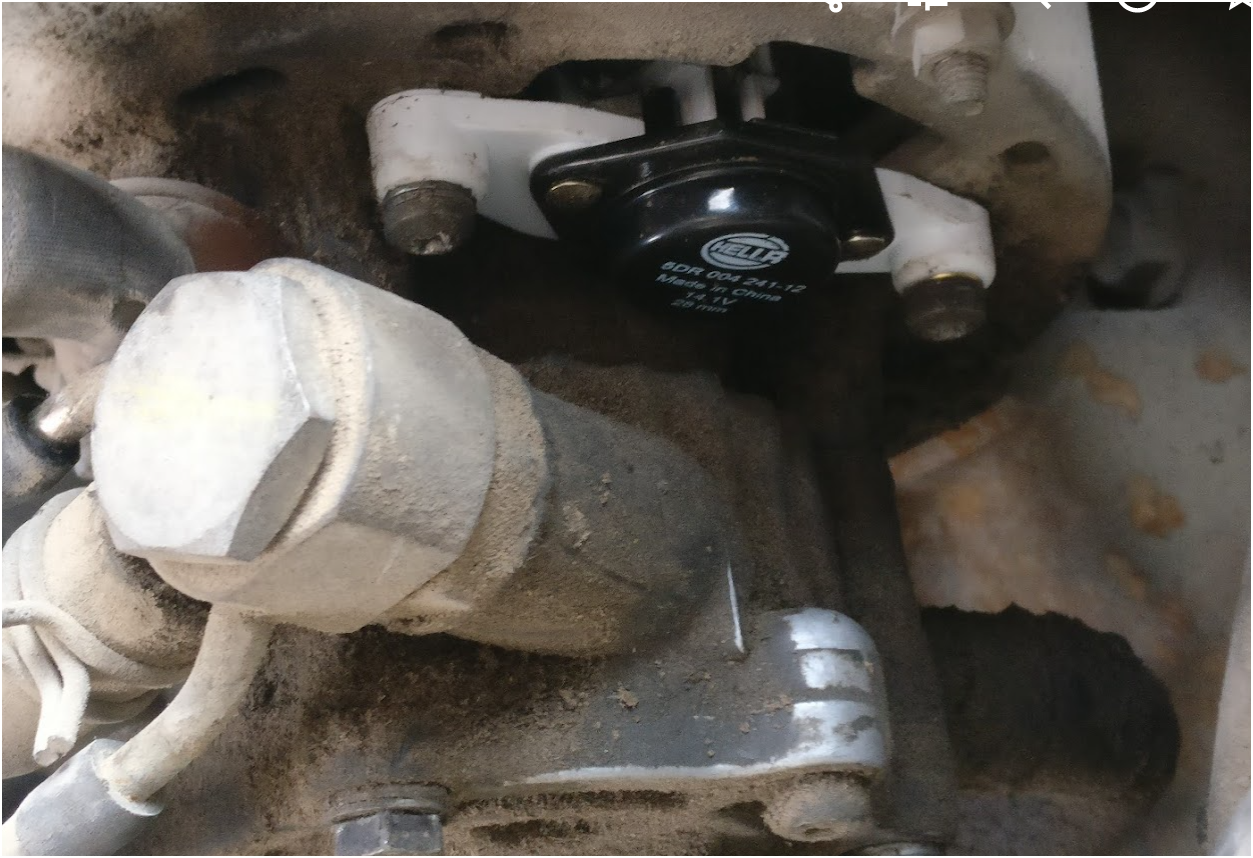

Finally got the new regulator in... got the Hella 5DR 004 241-121 but it looks like at least 3 or 4 different Hella regulators with slightly different part numbers are all identical. Not much left of the carbons. The little mini ratchet sure came in handy getting the regulator in without pulling the alternator out.
I let it run for a bit and the voltage when running is now up to about 13.5 but then the battery is really low, hopefully will come up a bit as it charges.
Platinum
Tight quarters!
