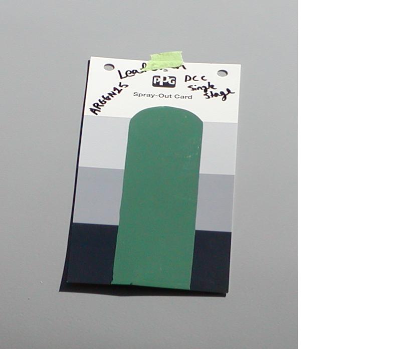

Local PPG supplier got the codes from TCP Global to mix me up this Leaf Green. Took two quarts of color for inside and outside of the bonnet and the door jams and outside of the car. Wish I had gotten 3 quarts with the mix run. Oh well.
