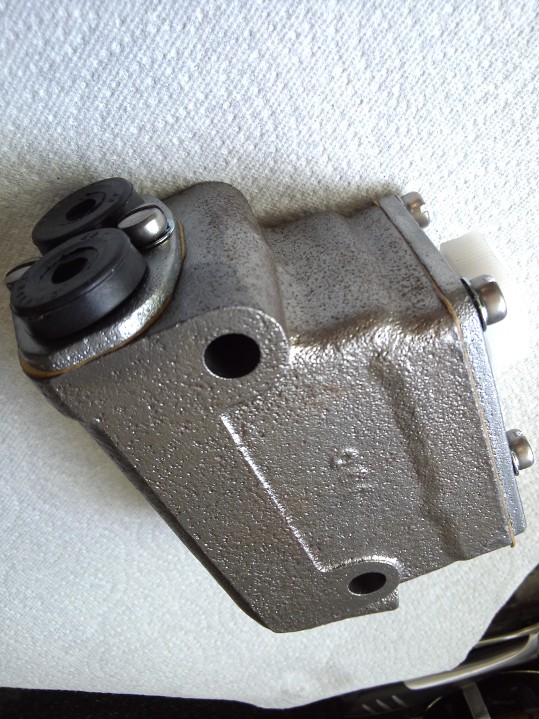

Sounds like a good use of clear then. Gerard sent me pics of my finished dual master and it looks so good as finished and sand blasted metal. Now need to see if clear Rustoleum needs a primer underneath. Sort of negates the use of clear otherwise unless only as a protective coat.

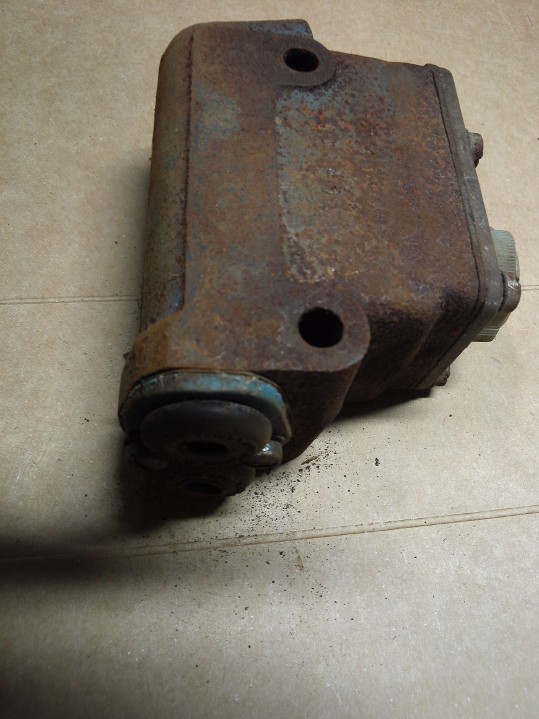

If you are referring to the cad plating, that soon became a non-option as we found that heavily rusted castings tended to stain the plating. Good condition castings were not a problem, but it was too unpredictable to continue.
Jim's casting was very heavily rusted, and would have not been a good candidate for plating. You can see the before and after below.
I suggested to Jim that he go with black, silver or "cast iron" brake fluid resistant paint. Powder coating is probably the best option, but should be done before the sleeving/rebuild procedure. They should be painted immediately or they will begin to flash rust fairly quickly, especially when handled with bare hands.
Jim has received hi MC as of this morning, so hopefully, we'll hear from him with any comments.

Thanks Gerard once again for your excellent work. Oh the details, the details. I will handle with gloves and paint immediately. It sure looks better than before. Now to get my hands on the late backplates I need to do a road trip to Cincinnati to pick up. Subassemblies are coming togather. Have everything now for Front suspension conversion to discs, have reworked Wishbones with new metal bushings, a list at least of all remaining parts and pieces needed to finish brake conversion.
