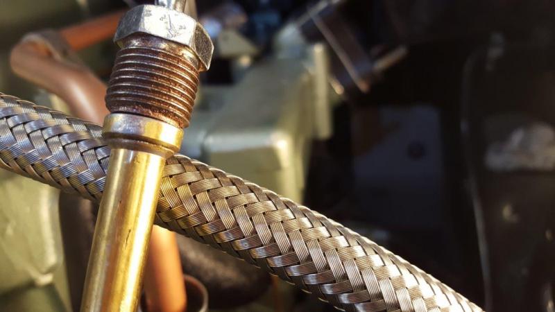

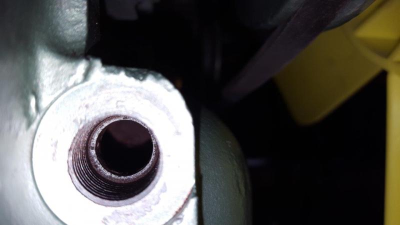

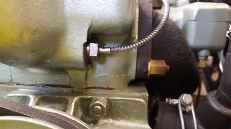

Hey guys,
I sent my gauges to Nisonger for a full rebuild. Nice work. They installed a new water temp line and bulb. I cleaned up the threads in the head and used copper never seize. The nut screws in by hand all the way. I ground down an open end wrench and used it to tighten the nut. The line can be moved slightly, and I'm sure coolant will blow by. I've tightened the nut as much as possible with an open end wrench. This nut seems soft so I'm a little nervous about over tightening. I'm considering modifying a 5/8" deep well socket as suggested by some guys on this forum. How much do I dare torque this nut? 20#? More?
I could also put a tiny smear of sealer on the seat but at this point it's still too loose for that to cure the problem.

I've used a Snap-on crow foot wrench on that, but that nut is really soft and I don't think an open end wrench is very good for avoiding damage. I'd definitely try the modified socket which should give you a better grip. As far as how much torque all I can say is twist it until it rounds off, then you know you went too far.

Do you have another gauge, working or not? If so, compare that to your rebuilt parts at the bulb/nut end. Even try fitting the other nut and bulb to see whether that tightens up. that might help you understand what is going on. As one possible cure, could you add in a copper or brass washer at the joint between the sending unit and the bottom of the hole to take up the slack?

I agree and to modify a socket for tightening use an old spare and ct a slot in it just wide enough to pass the copper tube allowing it to fit on the tubes nut .Waterpump pliers will let you grab it for tightening.
healeyblue
After you modify the socket, use a hose clamp around the socket as well when you are tightening the nut. It will help prevent the socket from opening up and slipping on the nut.

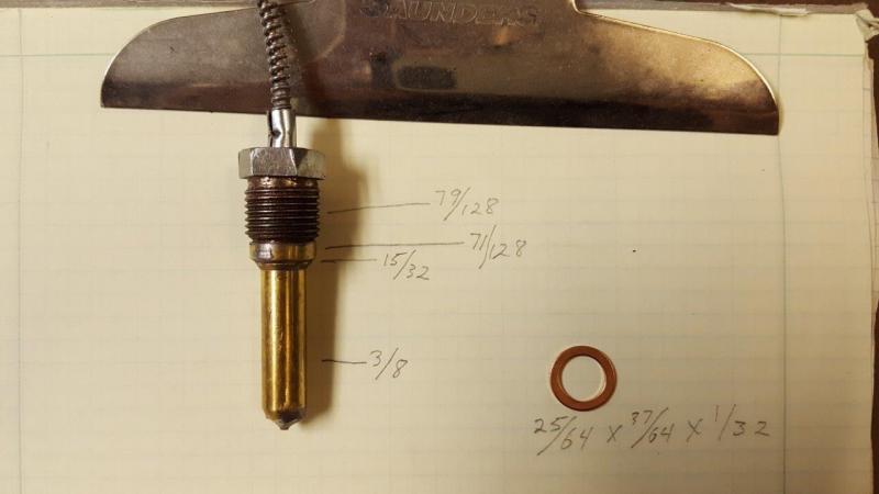

The attached pic shows the measurements of the water temp bulb and the nut. I found copper washers in the brake parts section of the parts store. As Randy said finding the best size is a small challenge. The one washer that I found, if my math is correct, is less than 3/100 over the widest point on the bulb. The threads in the hole bore measure the same as the widest point on the bulb. It fits the hole snug. This washer would have to be shaved. Emery cloth would probably work. Then add a very light smear of non hardening gasket sealer.
I did email Nisonger to see what his advice would be.
Thoughts anyone?
