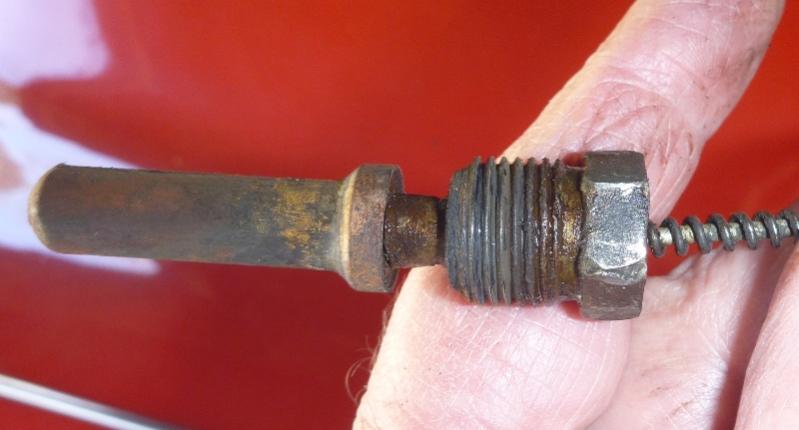

Yes, my sending unit has a male thread "Nut". It threads directly into the cylinder head. So on a later 3000 cyl. head such as a BJ7 or Bj8 I am still not sure what the thread is in the cylinder head.
steveg
Does anyone know the diameter and thread size for temp sender in the cylinder head. Thanks, Dave.
Just measured mine, which is out of the cylinder head - the threads are indeed 5/8 - 18
