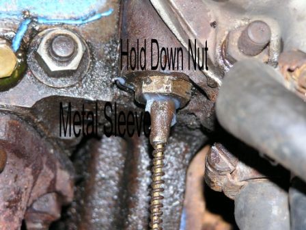

I'm bringing up an old topic but I ran into trouble today. I was taking the water temp sensor out of the thermostat housing and all was well till I went to put it back in. It leaks around the sensing line now. My question is, does the bulb and the nut make the sealing surface or is the metal sleeve supposed to be a part of it. My metal sleeve that seems to keep the spring around the line from rubbing on the bulb pulls in and out of the nut freely. I've attached a picture. Please pay no mind to the blue silicon attempt, I must have been sniffing too much glue or something..lol

My A series egine has an adaptor that screws into the head and provides a seat for the tempreature bulb to seal against. The nut on the temperature sensor then compresses the bulb into the adaptor, not into the head as shown in your picture. The adaptors sell for about $18.00 at Moss and Mini Mania.

Thanks man, that is exactly what I needed to know. I'll be ordering one tonight. Do they have the same threads as the nut?
