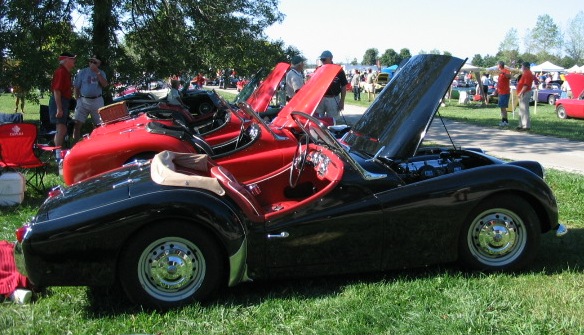

BTW, this past May 23rd, we celebrated my 50 years of ownership of "TRusty".

And Don, congrats on a half a century of owning the same TR3 from new. Great looking car. :cheers:
