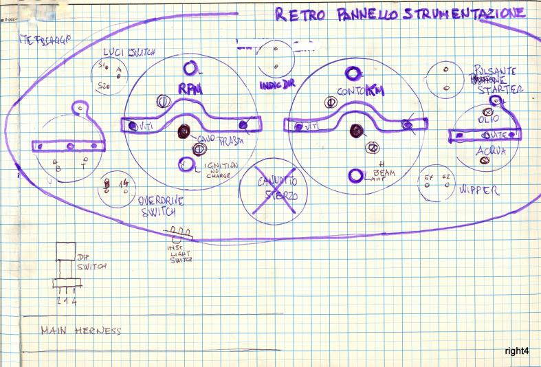

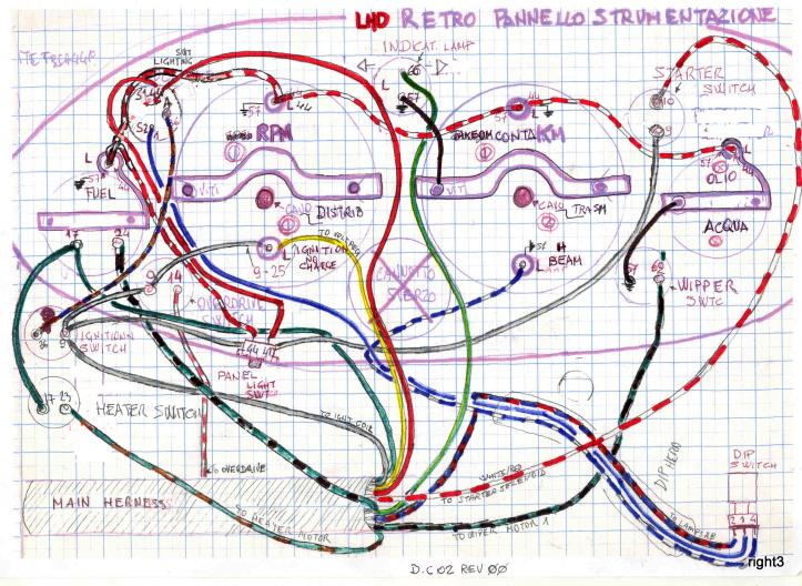

Where all should I have ground wires under the dash on my 100-6 BN4? I'm pretty sure I'm missing some...
Thanks!!
andrea
Here you can find some help
https://picasaweb.google.com/112770819864514987162/SCHEMAImproved1006
or
https://picasaweb.google.com/lh/photo/tToy4JvSKmiT5Mcbc1oZa9MTjNZETYmyPJy0liipFm0?feat=directlink
(File too large)
and also--https://picasaweb.google.com/112770819864514987162/DropBox
Cheers
longbridgehealey
Thanks, guys. I know this sounds insane, but someone swiped the ignition warning light and socket out of my car while it was parked in a parking lot last weekend. They cleanly cut the yellow and black wires leading to it, but they also pulled some of the harness loose. I think it's all back in place correctly, except while I was under there I noticed that the black ground wire did not connect to every instrument, it was not on the speedo, and was doubled up on the tac. Didn't seem right to me, but I wasn't sure if it mattered, since its obviously been running that way for years. Diagrams helped, thanks, Andrea:smile:

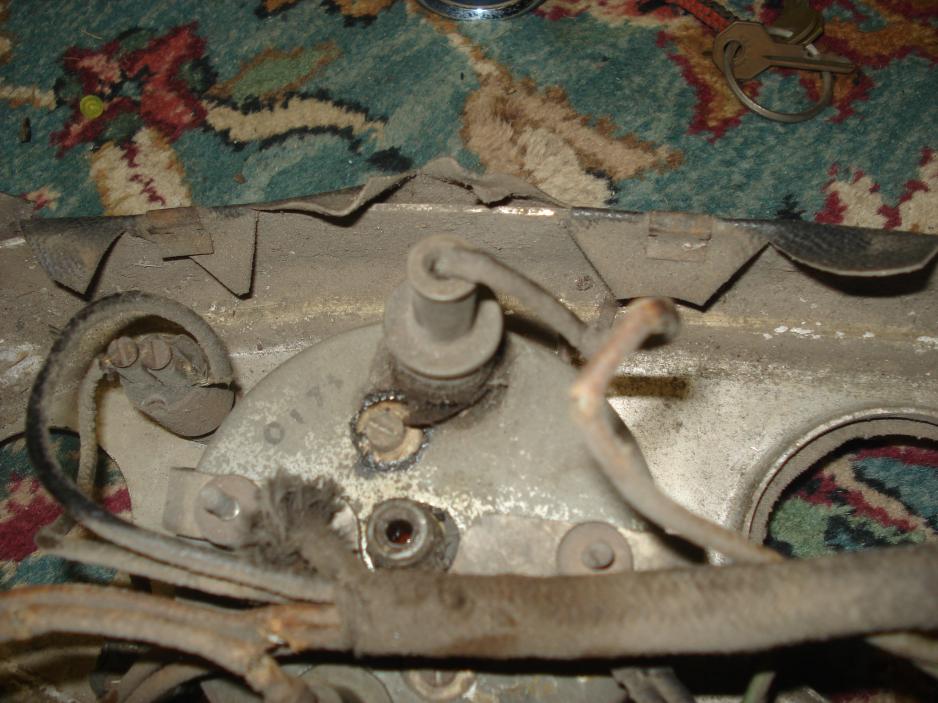

Ignition socket? do you mean the turn indicator socket? the ignition lamp is in the tach. If you need a replacement I have an extra. PM if you need it.

Having emailed back and forth with Larry about his ignition light issue, I believe he needs the actual socket that is crimped into the back side of the tachometer, so if someone has a braken tachometer for parts I bet he would appreciate the offer, because I think that is the only way he will get a bulb for his ignition light. Here is a picture of what I believe he is missing.

Yep, that's exactly what is missing. Thanks, Jim, for posting it.
Larry
bob hughes
You can get new lamp holders for the tachometer from good old Britain if you are stuck. There are a number of suppliers but try - www.vehicleproducts.co.uk, they do what they call pilot bulb holders in two forms - traditional and also for the 9.5 mm wedge shape bulbs.
