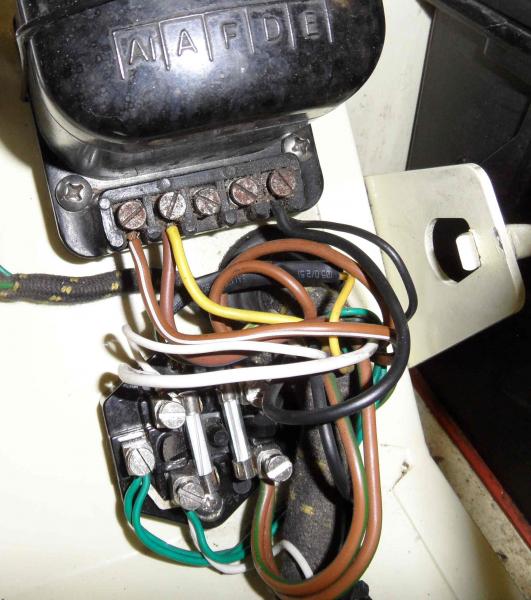

Couple of things about the alternator conversion. The wiring in the back of the old voltage regulator can be changed and will let you keep things as original. Read up on how to do this. Your lights will be brighter and if you go with relays and ground strips to the frame, even better.

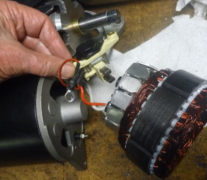

Purely FWIW, I "rolled my own" conversion using a 45 amp unit originally from a Suzuki Swift. It does look like an alternator, of course, but it fits perfectly and with no modifications to the engine.
I did modify a control box (not the original one), but the mods aren't visible.
Here's a shot showing how it mates to the original generator bracket.
I previously ran a 60 amp Ford alternator (on a previous TR3A) for close to 30 years and never had any problem with the original wiring harness. But I did use heavier wire from the alternator to control box area, and tied my added loads (120 watt headlights, electric radiator fan, high power stereo) directly into that wire so that current to run them only ran through the original harness when the engine wasn't running fast enough for the alternator to keep up.
