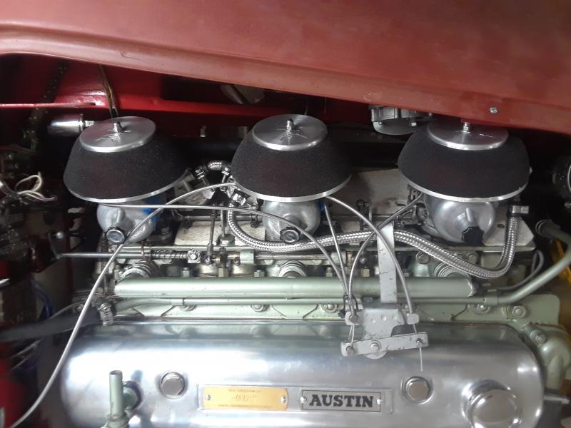

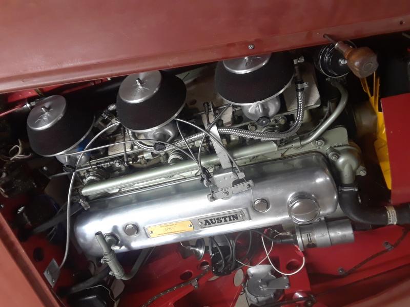

Thanks for steering me away from the oxygen sensors and any other words of wisdom and if any can help with my upside down pics, I'd appreciate that too 20181010_203619.jpg

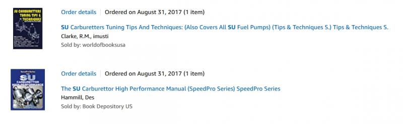

I haven't done the super-duper stuff like shaving the throttle shafts. Dave (Red57) is the guy who turned me on to the books. Perhaps he'll respond.
I'm happy to have books that tell how the carbs function and stress how important equal float levels are, etc. The dark blue SU book also has illustrated step-by-step rebuilding for all the carb models - a big benefit.
