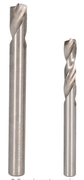

Drilling out old rusted floor panels, I intend to MIG weld in new panels. Will have to drill out a billion spot welds. I have cobalt spot weld drill bits, 6mm and 8mm.

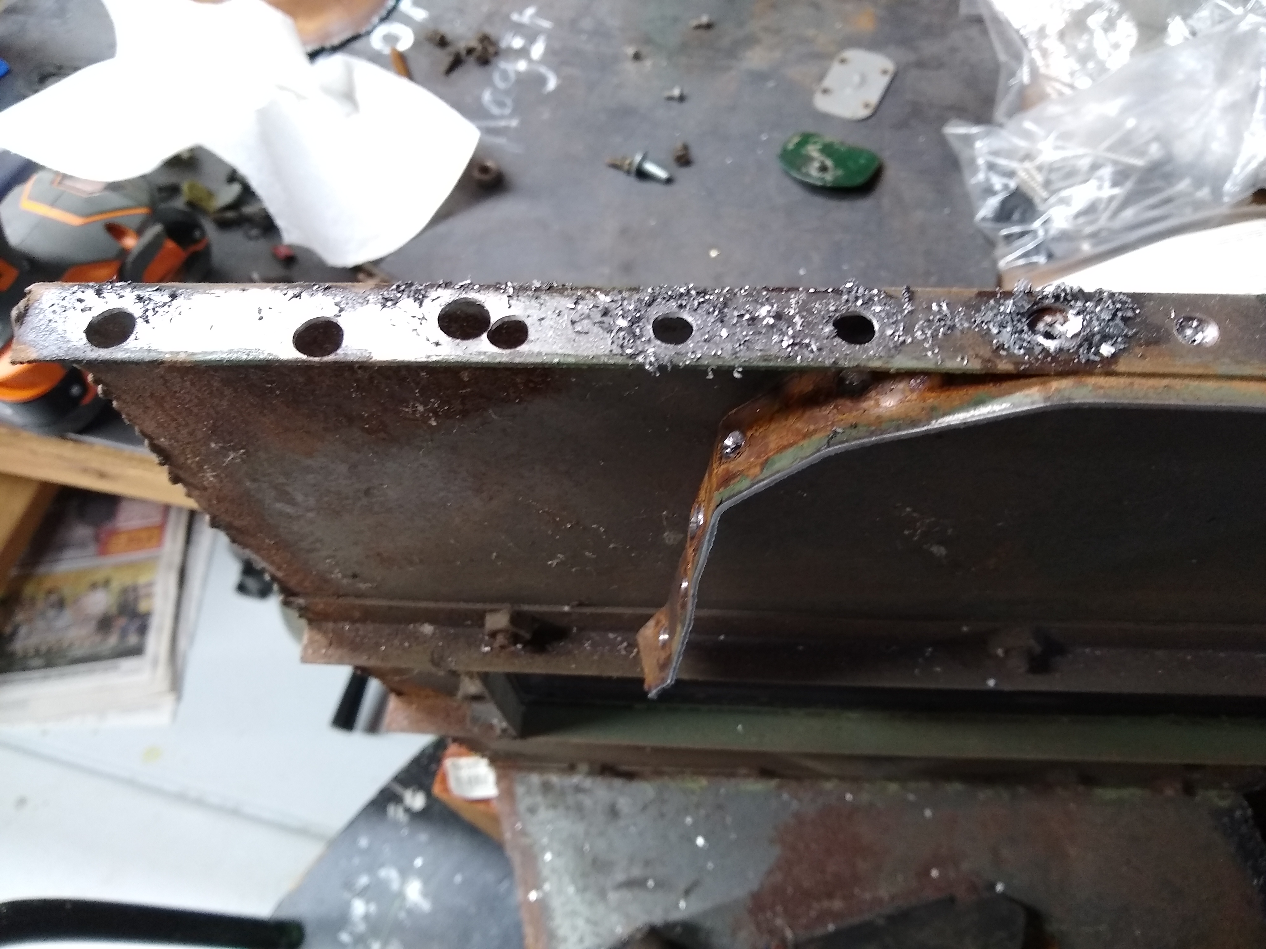

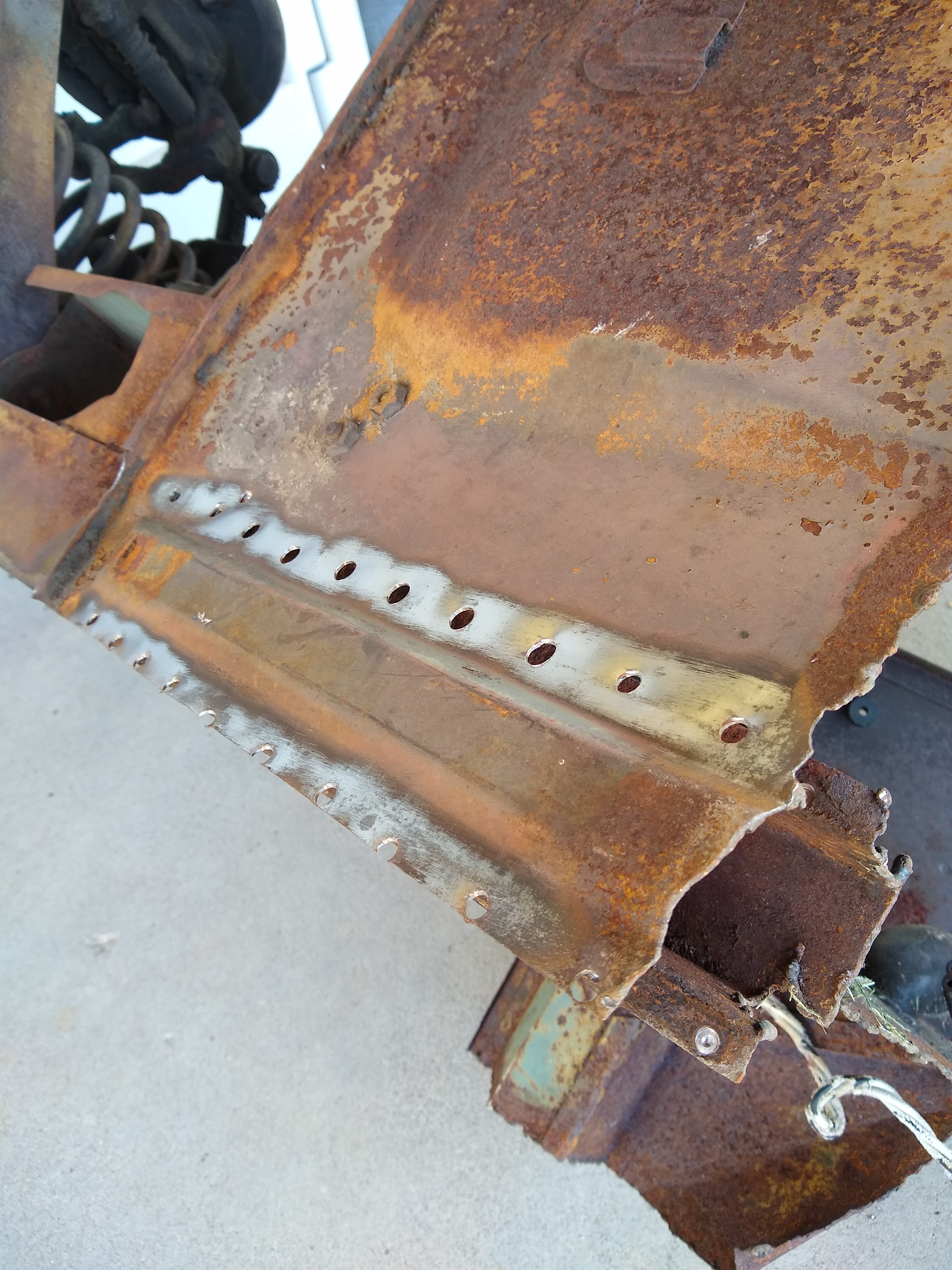

Thanks all. I have some front end scrap that I have practiced on to remove the welds. Now I think I should also practice welding the metal back like I will have to do with the new floorboards to see what works best. Below is a photo of my practice, but...I am inclined to change my method and drill from the top because when I have to weld the new steel on I would not be able to do that from the bottom through the new steel floor pans without knowing what was above. I'd be welding blind unless I drilled holes, another complicated step to get right. Think about it and I think you'll come to the same conclusion. I just have to practice welding through the top hole so I make the least mess possible.

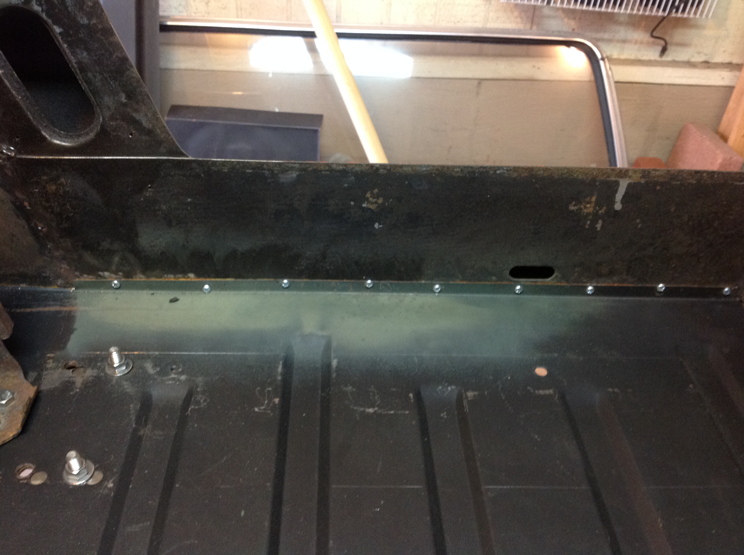

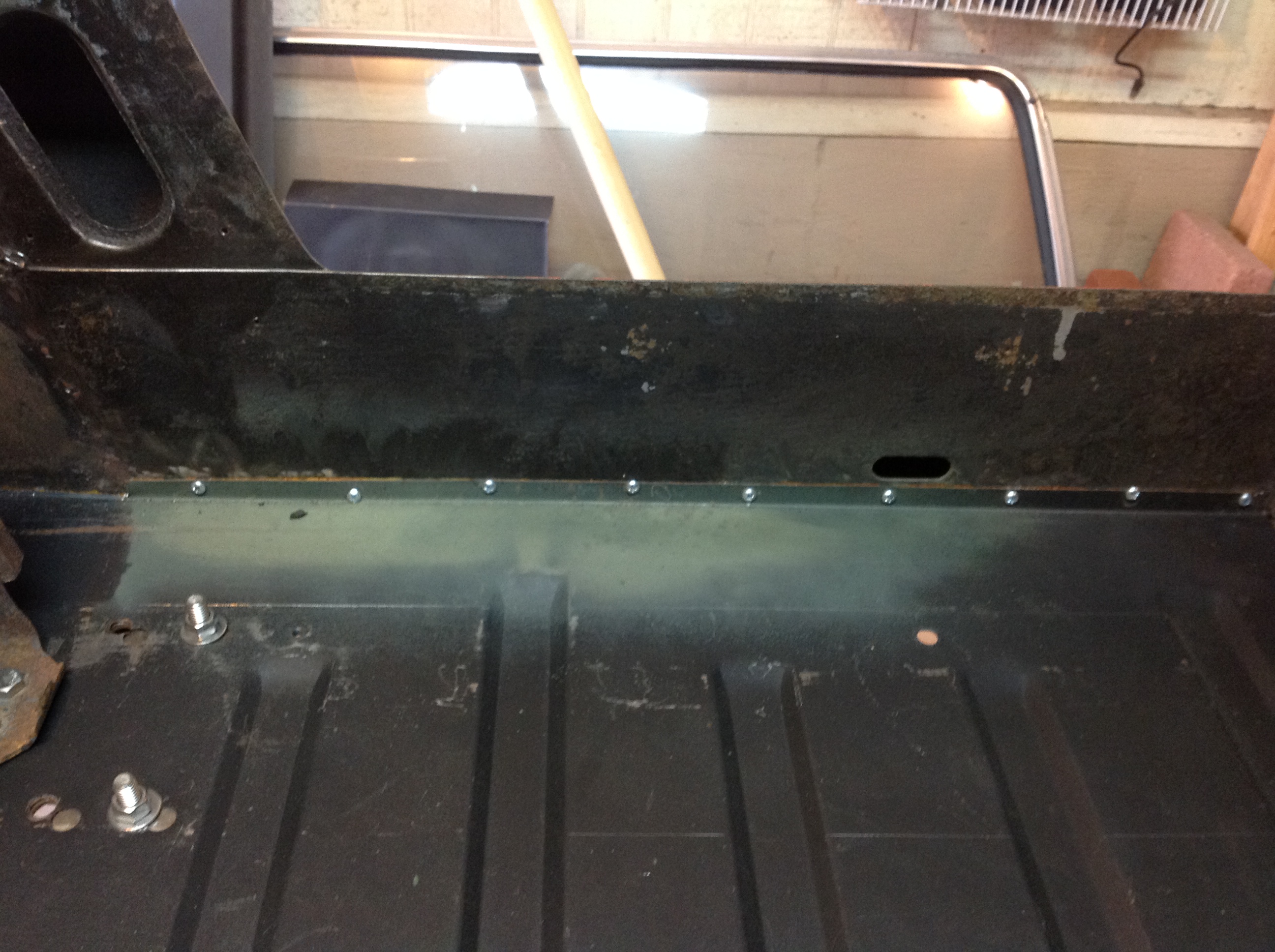

I like to drill all the way thru with at least a 1/4” drill and then weld the floor thru those holes. I also use self tapping screws to hold everything tight while I weld. Also cut the vent out to weld to the new floor pan or make a new one.

I like to drill all the way thru with at least a 1/4” drill and then weld the floor thru those holes. I also use self tapping screws to hold everything tight while I weld. Also cut the vent out to weld to the new floor pan or make a new one.View attachment 73019

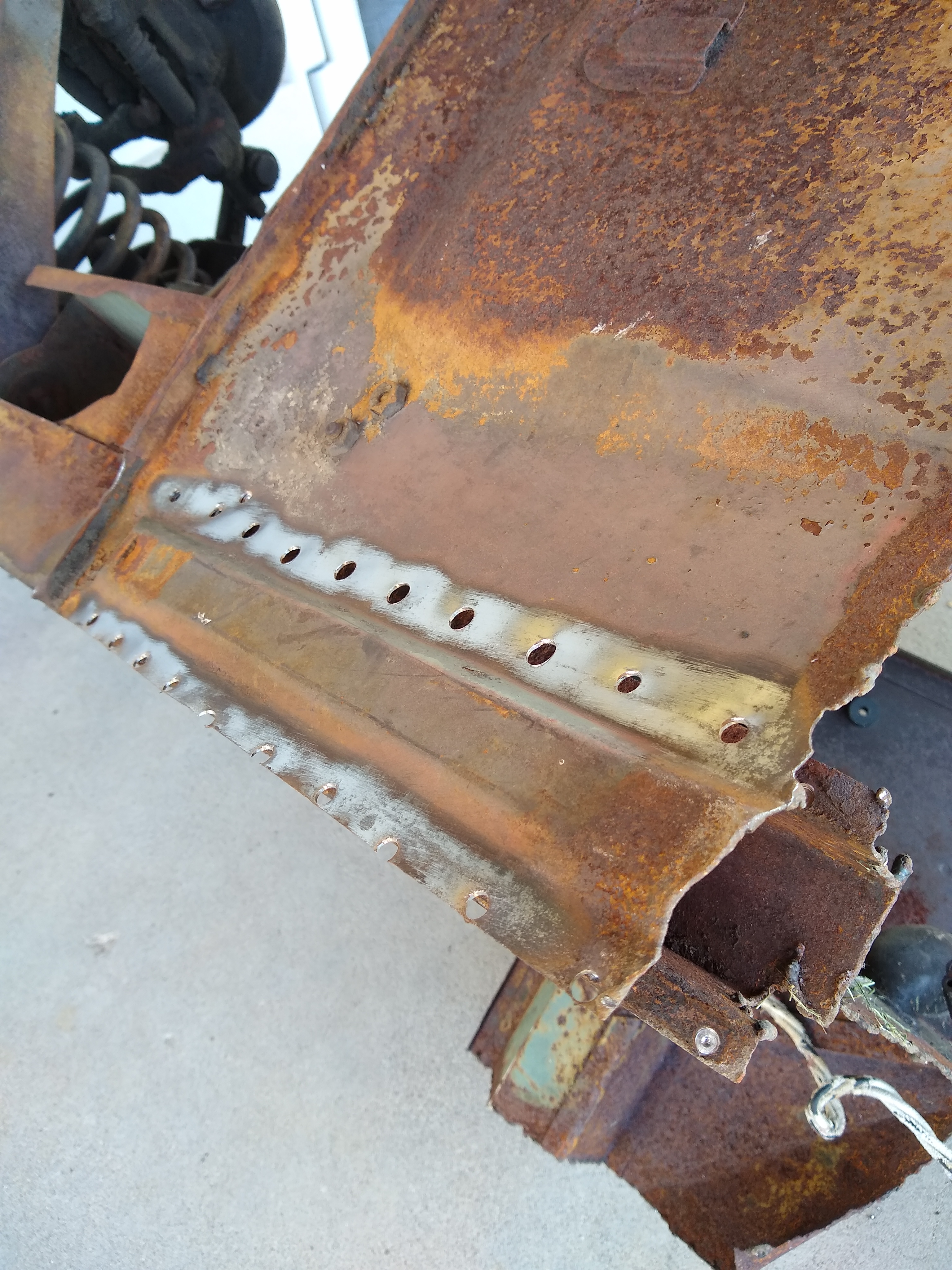

Thanks Rut and Apbos, I am finding that a plain old 1/4" drill bit seems to work as well as any specialized weld remover bit, although cobalt is probably the best choice for longevity. I think if I cut away the majority of the old floor and just leave the welded strips I will find that they push away if you can start from one detached end of metal. As soon as you go through the top layer the bottom releases and bends away, so no need for chiseling or anything else, and a minimum of drilling. This is another test panel to illustrate. The big holes are 8mm and small ones are either 6mm or 1/4", indistinguishable from each other. 1/4" seems sufficient to remove spot welds, I don't think anything bigger is needed.
