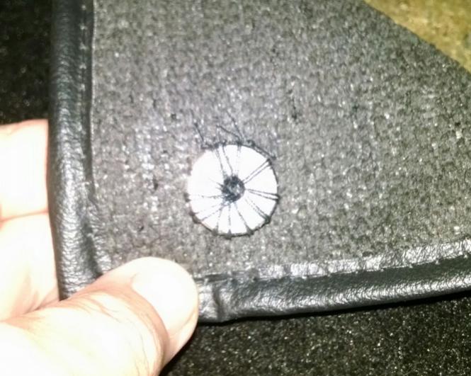

I am installing my carpet set in my BJ7 I got from Heritage. I bought the Moss video that says for BJ7 and BJ8. Unfortunately most of it I think is for BJ8. I have 2 question so far. 1 is how does the carpet lay behind the seat in the corner where the heel board and and shut pillar meet. Where that little “ramp” section is. It almost seems if a relief cut needs to be made so carpet will lay flat on the floor but then floor will show???? Also what gets put in 1st for best fit, the floor pieces or the transmission tunnel piece. Thx any and all help, especially pictures are much appreciated.

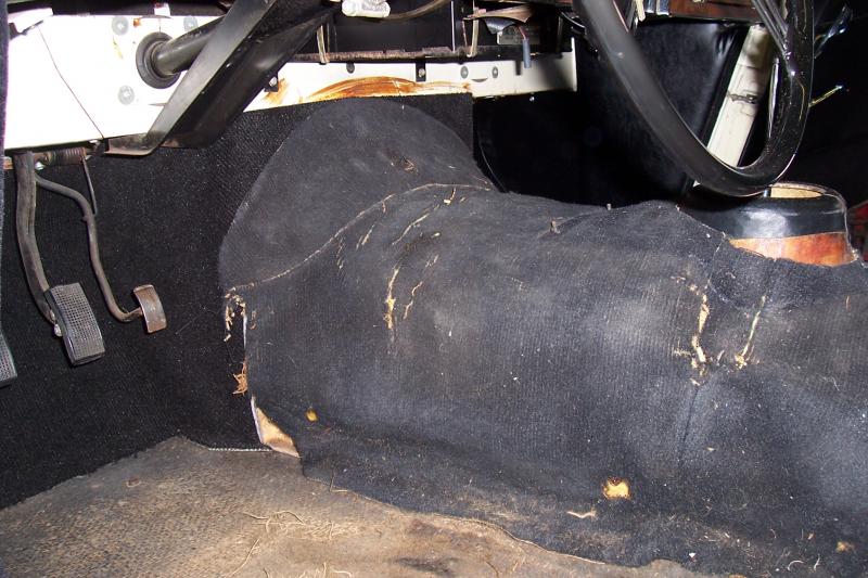

Do these photos of an original carpet install help? These photos are from Carroll Phillips of Top Down Restorations in NY. I have other photos of mine in more detail.

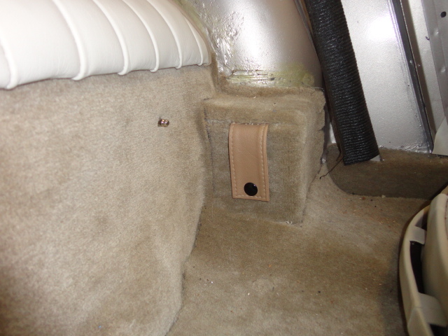

Patrick, thanks for the help. Unfortunately the area I am trying to figure out isn't in the pictures. I am trying to see how the carpet comes together behind the seats toward the heel board on a BJ7 near where the shut pillar is. Thx again, Pete

Okay, you’re wanting the area behind the front seats to the bulkhead located at the front of the rear seats?
Patrick67BJ8
Correct, I can’t seem to figure how the carpet lays and I am nervous to cut anything. Thx
Here's some the original BJ8 carpet photos and photos of my BJ8. The Radius Arm boxes do not apply to your Healey.
Just remember to error on excess material when trimming because you can always trim more off if needed.. Save all your cut off pieces! Carpet goes under the rear quarter panels.
I fitted and chalked and retested and retested before I cut. Always good to have you rear quarter panels handy for trial fitting!
Take your time.

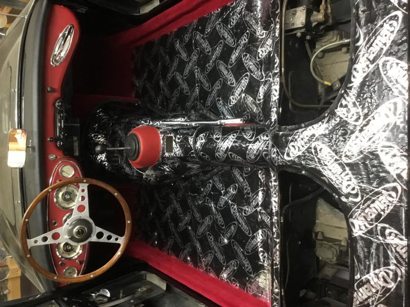

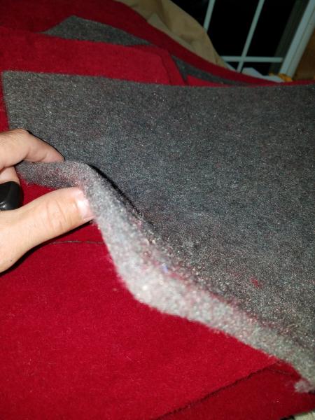

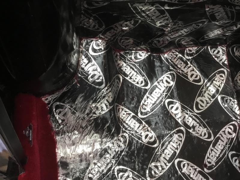

Patrick67BJ8

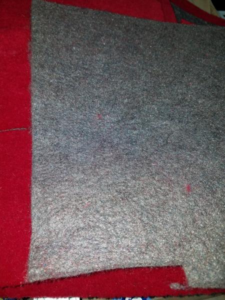

No, I am putting Dynamat Extreme down and then the padding that Heritage supplies with their Wilton Wool.

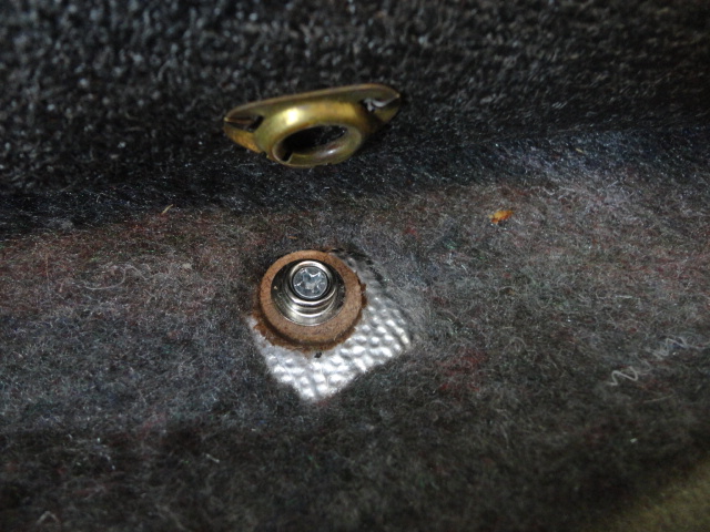

Heritage supplied me with thick jute padding. You received something different than that? Also, are you going to use the original snaps to hold the trans and floor carpets in place?
P
PeterB
I don't believe mine is jute, it doesn't have that web backing and its not that thick. The only pieces that came with the kit go in the toe box area and under the floor. My original snaps were gone when the fiberglass on the transmission tunnel got redone only the holes remain so I have to use the ones that come with the kit.
Patrick67BJ8
Can you post photos of it?
