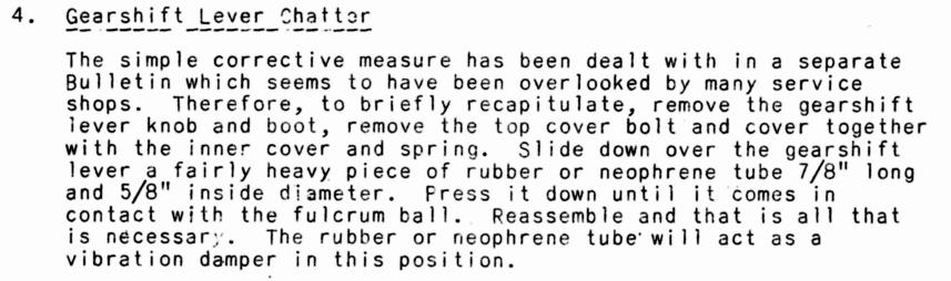

I removed my gear shifter assembly from my trans to install on my new overdrive transmission.After cleaning I realised the bottom of the lever has a small hole,about 3/16,drilled in one edge of the flattened out end.Is this hole oriented front or back,or doesnt matter?
Also while I have it apart ,what is the shifter anti-rattle trick?I recall suggestions of rubber hose on lower
lever.
Any other suggestions on proper reinstall of lever assembly appreciated.
Thanks
Tom

Thanks Randall for the link and attachment.I looked at plate K in 4th edition spares catalog and no spring/plunger shown,but now I seee Moss shows the anti rattle spring and plunger.
Thanks again
Tom

Standard Triumph designed a fix for the persistent rattle in the gearshift column, which is discussed in some repair manuals. It’s called the “anti-rattle” spring & plunger. Unfortunately it doesn’t completely solve the problem.
Try this: Remove the gearshift lever knob and boot. Remove the top cover bolt & cover together with the inner cover and spring. Take a piece of heater hose 7/8” long and 5/8” inside diameter. (Common item at your parts store) Slide the piece down over the gearshift lever until it comes in contact with the fulcrum ball. Reassemble & you’re done!!
