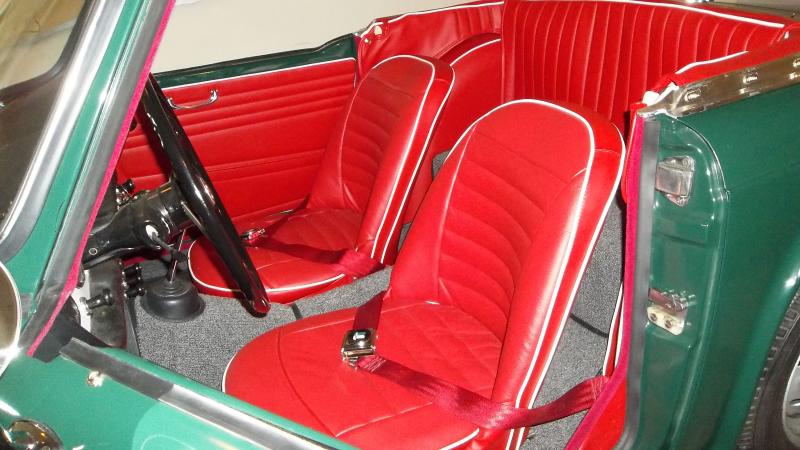

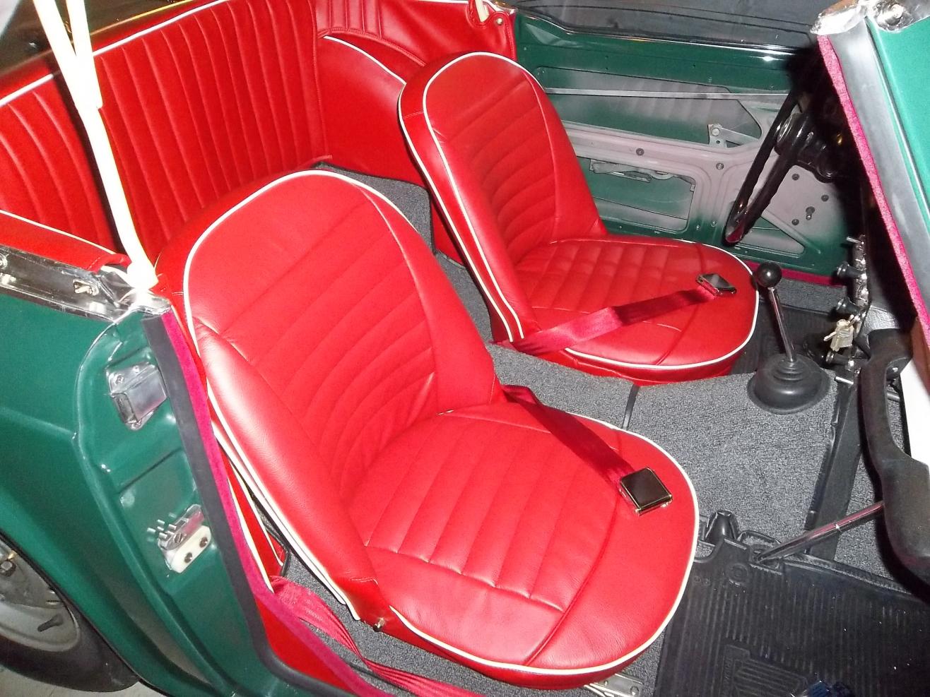

I restored by TR4 with the early TR3 style seats around 2 years ago with all materials from The Roadster Factory.
I went with the red leather and the seats came out looking very nice.
The only item I could not find when I rebuilt them was the wood strips that are on the bottom of the seat back and bottom. Shortly after I finished my rebuild, TRF began selling them.
If you ever decide to sell the car, you will have a larger audience of potential buys if you keep it original looking in my opinion. When I bought my TR4 in 2008 specifically for the purpose of restoring, I avoided all the cars that did not have the original seats.

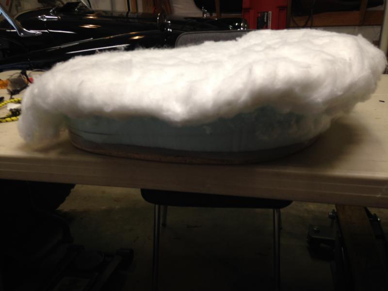

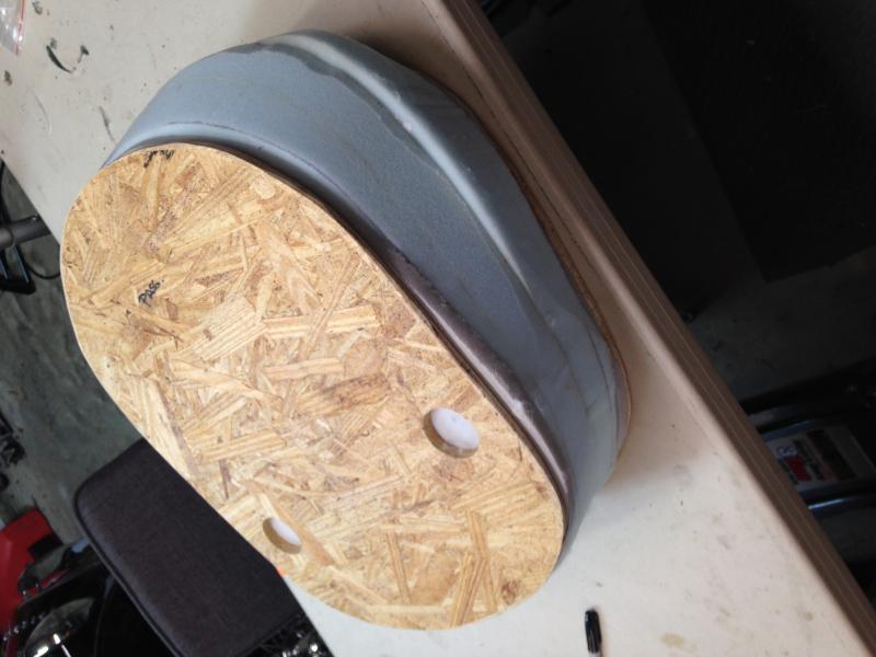

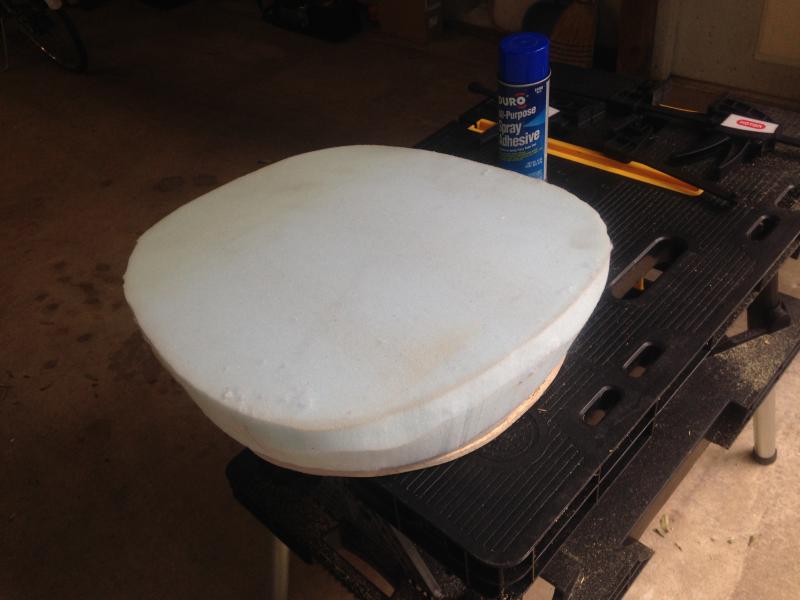

I was missing a seat when I got my TR3, so my decision was a little easier. I got a complete set off ebay with new foam, covers etc for about $500. They look a lot like Geo's. But I am 6'1" and couldn't fit in the car with the top up. Any hat blew off with the top down because the top of my forehead was above the windshield. I took the bottom cover off, cut about 4" of foam off the bottom of the seat, and put the cover back on. Being a few inches lower, now I fit, and my hat stays on. The seats look original and are fairly comfortable. I've only driven a few thousand miles in one day, but I doubt any seat will make the TR3 more of a comfortable cruiser.
If you go with modern seats, I'd also look into ones that have speakers in the head rest. I am happy with my modified stock.
