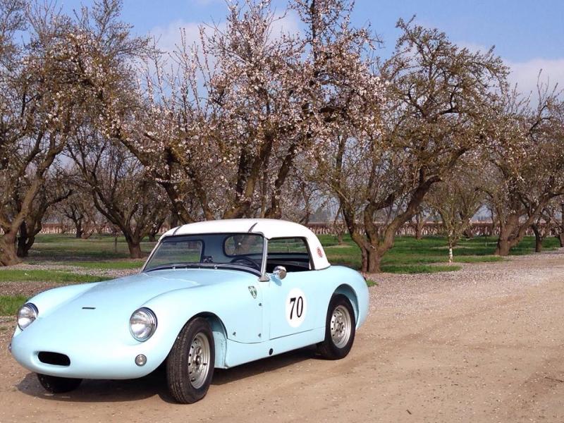

apbos
I have a Speedwell monza bonnet on my sprite. I found it used, but unfinished. It took very little to prep it for paint and is very solid. The inner bonnet is finished to an acceptable level and after cleaning was ready for primer and paint. Some hot rodders here will shoot the inner bonnet with truck bed linner to hide the fiberglass matting.
Regards
Paul
